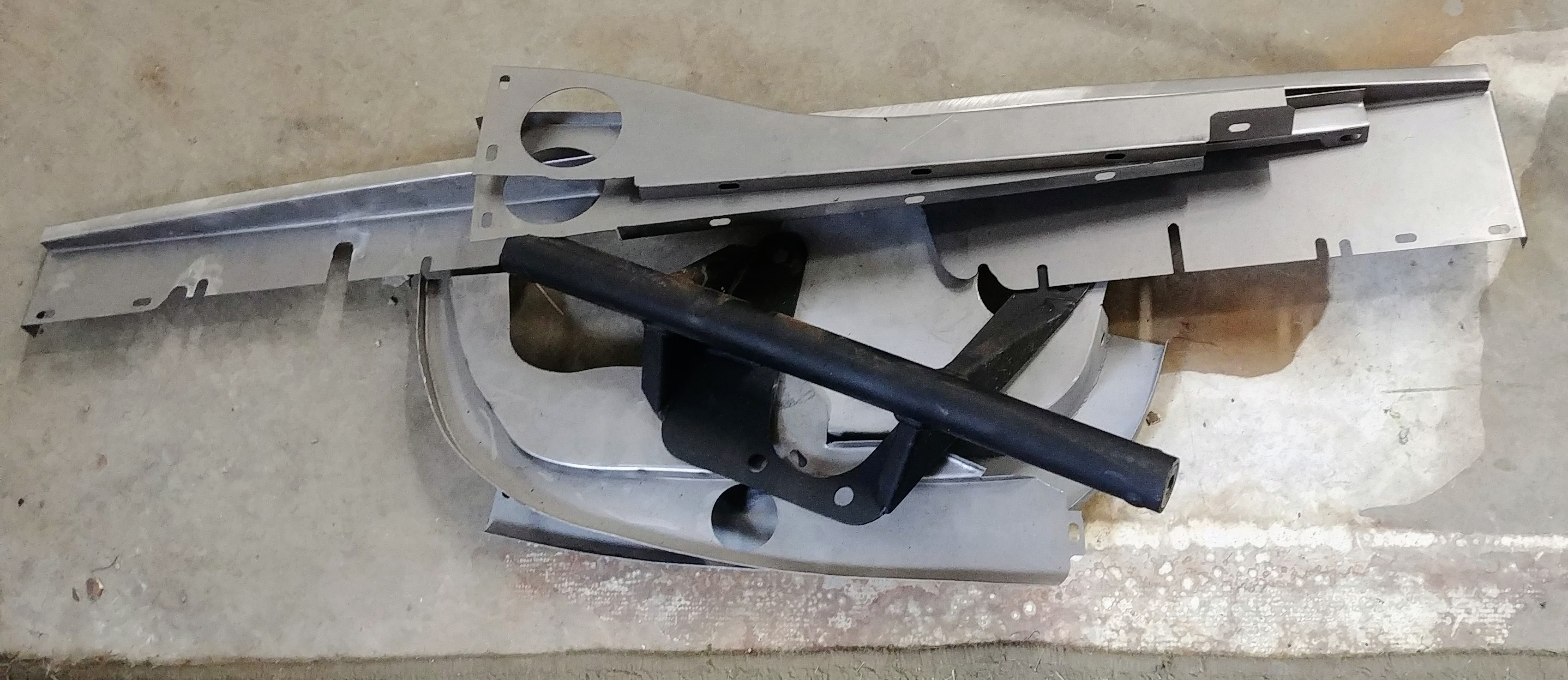

Engine is here , new clutch, trans rebuilt @914ltd and throttle linkage @a914guy
Sheet metal off for powderpaint tomorrowAttached Image Attached Image

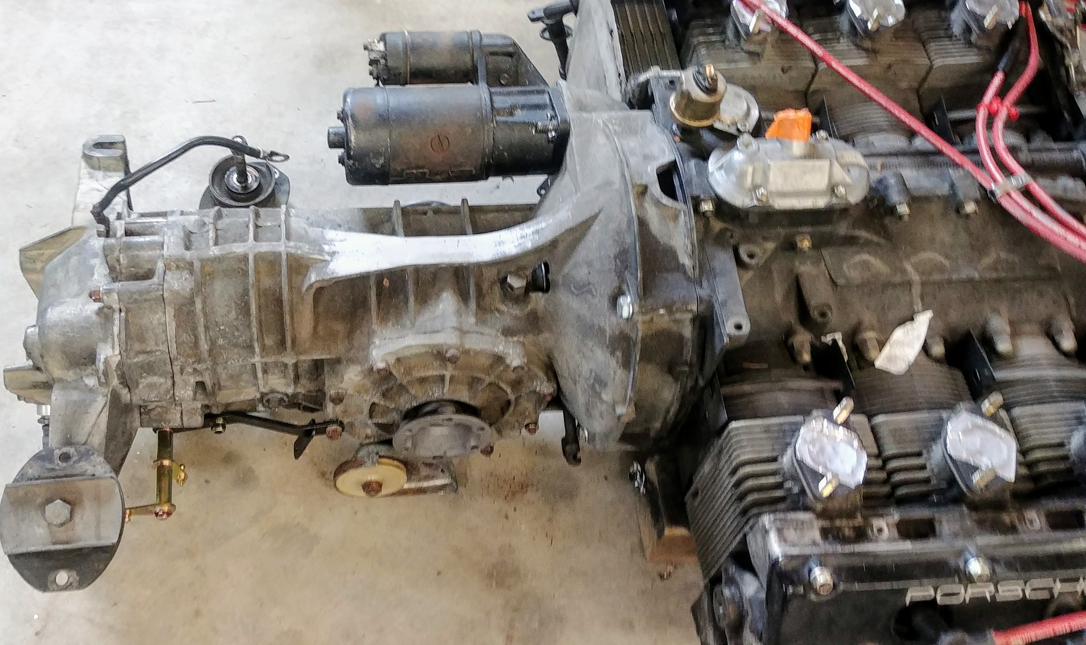

mb911   Here is the engine prior to my removal.. Hopefully...   Apr 27 2019, 05:40 AM
