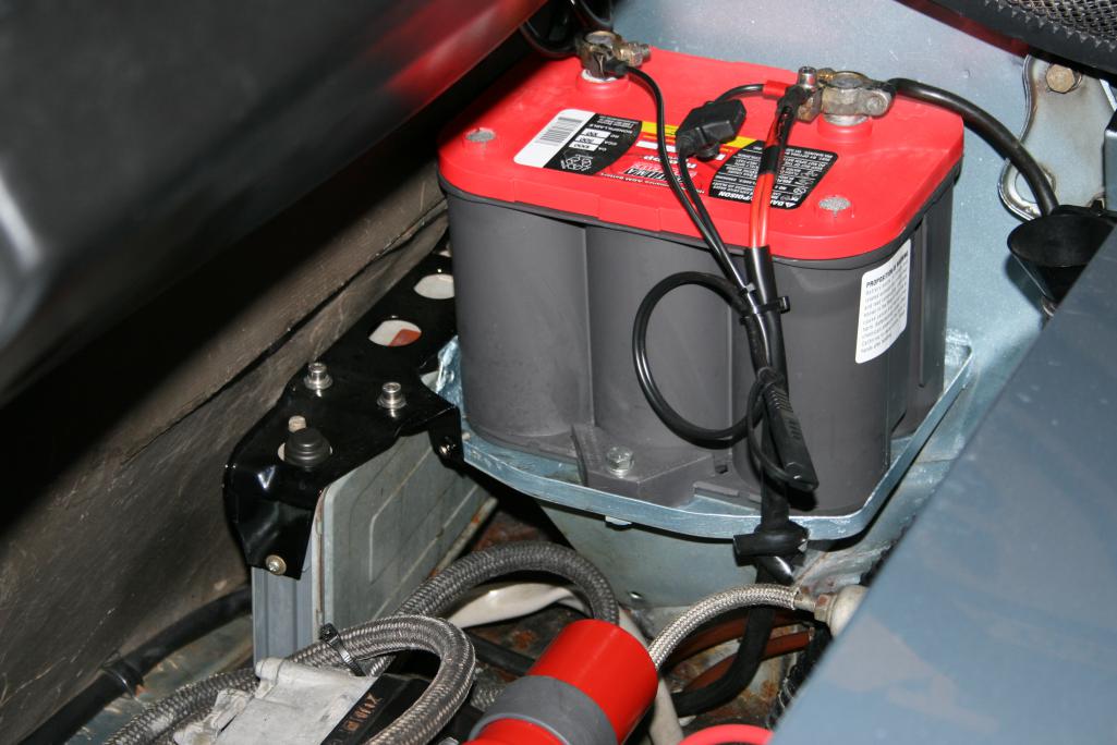

This Optima battery is about ten years old & works just fine. FYI.

windforfun   This Optima battery is about ten years old & w...   May 21 2019, 10:02 AM
