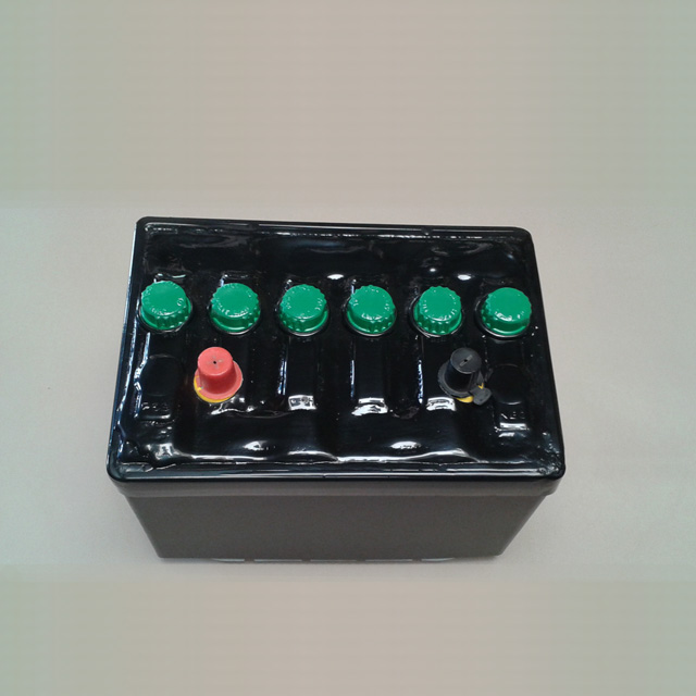

(IMG:style_emoticons/default/confused24.gif) You want it for period correct Look?
They make covers for the Optimas Odedessy Even Delco and Deka that make it look like the old lead acids, if you are going period look.
Tar Topper Make Modren Starting Power look period correct
