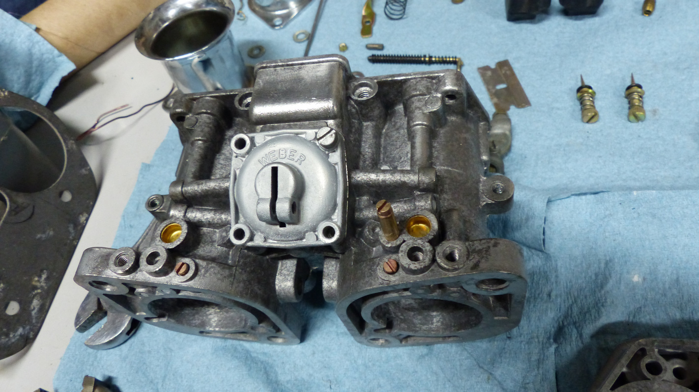

I finally got around to this project. I have the first one squeaky clean from a functional standpoint but the corrosion left dark stains in the bodies I wonder if anyone knows a magic trick to get rid of.
I have new accelerator pump diaphragms and all rubber seals coming from Pierce Manifold. My float needle valves are solid brass and look brand new so I didn't order replacements.
Here's what the body looked like after disassembly. Since this carbs have never been used, I wasn't surprised they came apart without any fights or mishaps. Plenty of nasty corrosion though.
(IMG:http://www.914world.com/bbs2/uploads/post-20845-1558414550_thumb.jpg)
(IMG:http://www.914world.com/bbs2/uploads/post-20845-1558414588_thumb.jpg)

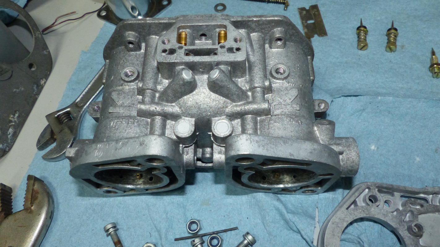

Since there was never any fuel in it to form petroleum based gunk and varnish, I skipped Berryman or any other strong solvents and just soaked the stripped body in diluted Pine-Sol, followed by rinse dry, then soda blasting, then rinse and dry. It's nice and clean, but rather ugly. Here's the worst side:

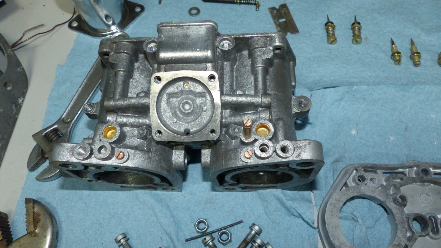

The other side had less corrosion and looks better, but not great:
The accelerator cover cleaned up nicely and is more what I was hoping the bodies would look like after soda blasting.
A few things I've tested in hidden spots to try to brighten the dark spots are: Mother's Mag Polish, white vinegar, Griot's Diablo wheel cleaner, Jay Leno's Garage wheel cleaner. None worked. I have not tried oven cleaner, lemon juice, or boiling in anything.
Anyone know any tricks to make these look new again? (IMG:style_emoticons/default/confused24.gif) I'm getting worried there was some kind of protective coating applied that the corrosion took away. (IMG:style_emoticons/default/sad.gif)
