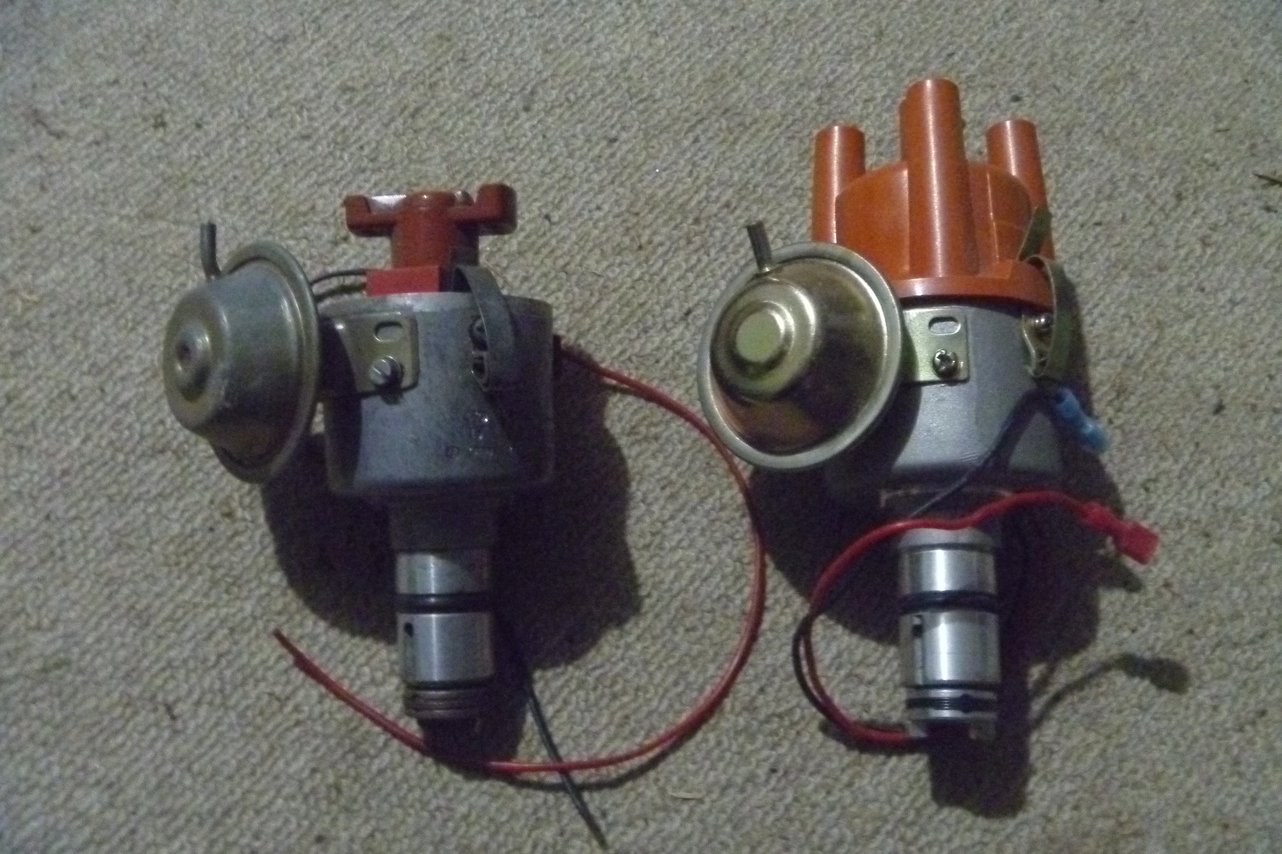

Very sound advice,the whole issue with the 09 is it advances to fast,these and the old 010's were basically made to work on industrial engines that required a fast advance when responding to a governor,and yes they made T4 industrial motors .
Fitted to a car engine this advance is just ok but causes somewhat of a "stumble'' as the advance is a little too much for the vacuum getting to the carb /carbs.
The Bosch original so called SVDA provided a slower increase in early advance from the vacuum side to the max set point of movement on the advance plate the mechanical side takes over till total advance is reached,so this all equals a smoother throttle response which tends to match better with carbs.
I have an original SVDA and a chinese knock-off, IMO the copy is pretty well made but will NEVER last as long as the Bosch,wee tip is to replace with Bosch the cap and rotor as not sure how good those parts are on the chinese unit.
On a fairly stock motor tuned well you will be fine ,rant over good luck.
