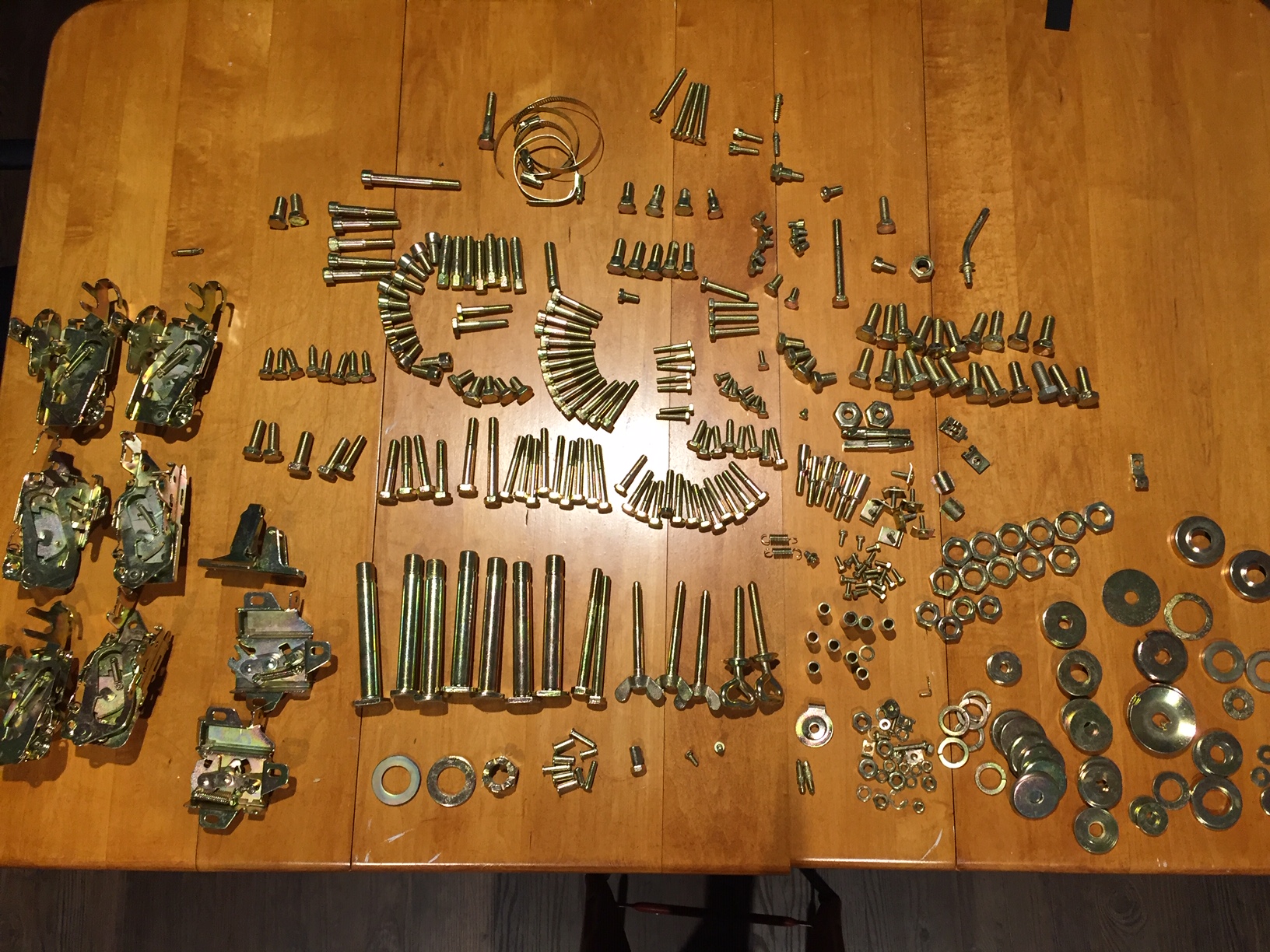

> Bought a vibrator
post Apr 29 2019, 02:18 PM
914-6 GT in waiting
Posts: 20,924
Joined: 19-September 09
Member No.: 10,825
Does a good job cleaning up the parts but leaves a residue. I bought some kitty liter and home that will work to clean it up and give it a final polish. It’s loud but I found a place in back of the building so it’s not so annoying.
post Jun 10 2019, 07:00 PM
914-6 GT in waiting
Posts: 20,924
Member No.: 10,825
Last batch for now.
