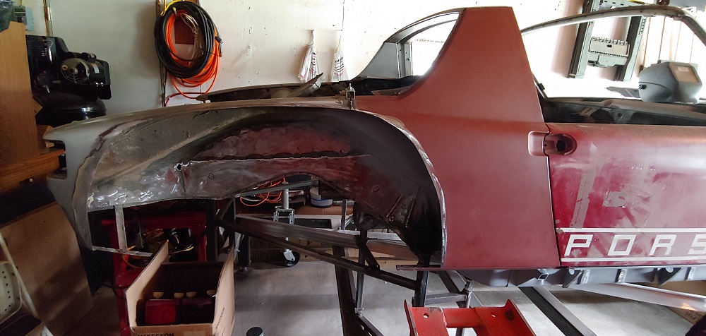

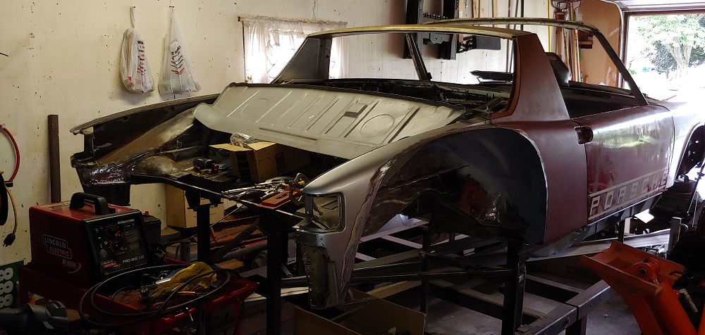

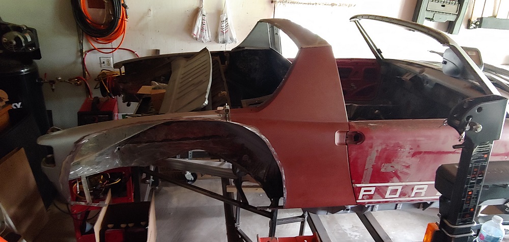

We've been working away slowly on my brothers 914. When we went to replace the rear trunk pan we found that the rear panel was damaged at some point in the past. Looks like it was backed into something vs being hit in the rear. So off it came and a new section was ordered from our friends at RD. Also in the works is the steel flare install.
