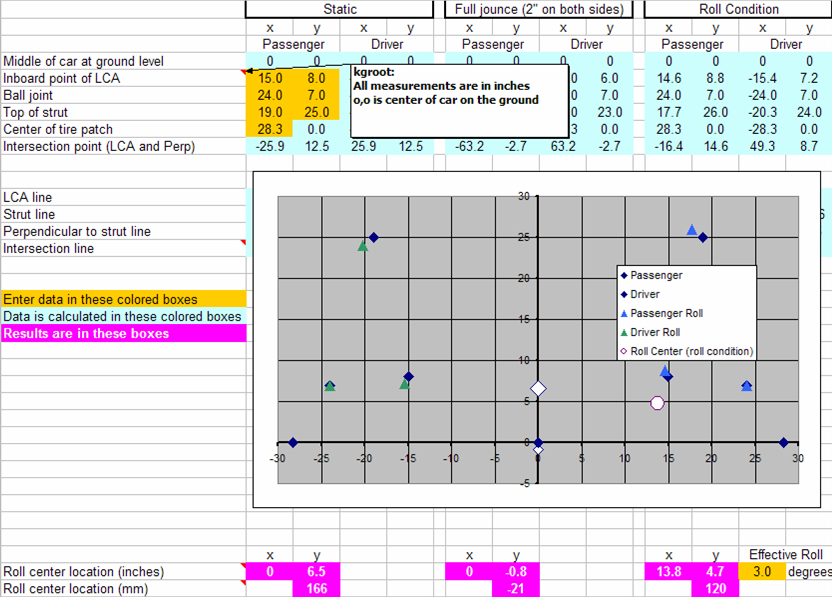

The hollow diamonds are the roll center locations with no roll (large one is static condition, smaller one is 2" jounce condition). The large hollow circle is the roll center under roll condition, in this case 3 degrees.

groot   Here's a simple front roll center calculation ...   Dec 1 2004, 07:26 AM
smdubovsky   Interesting thread. Kevin, When I d/l your spread...   Dec 1 2004, 07:43 AM
groot   Excel for XP.... don't know why it does that. ...   Dec 1 2004, 08:00 AM
groot   And now with a simulated lowered 914....   Dec 1 2004, 08:01 AM
Jeroen   Kevin's excell sheet can be downloaded here: ...   Dec 1 2004, 08:31 AM
groot   Maybe some more explanation would help... The cha...   Dec 1 2004, 08:38 AM
