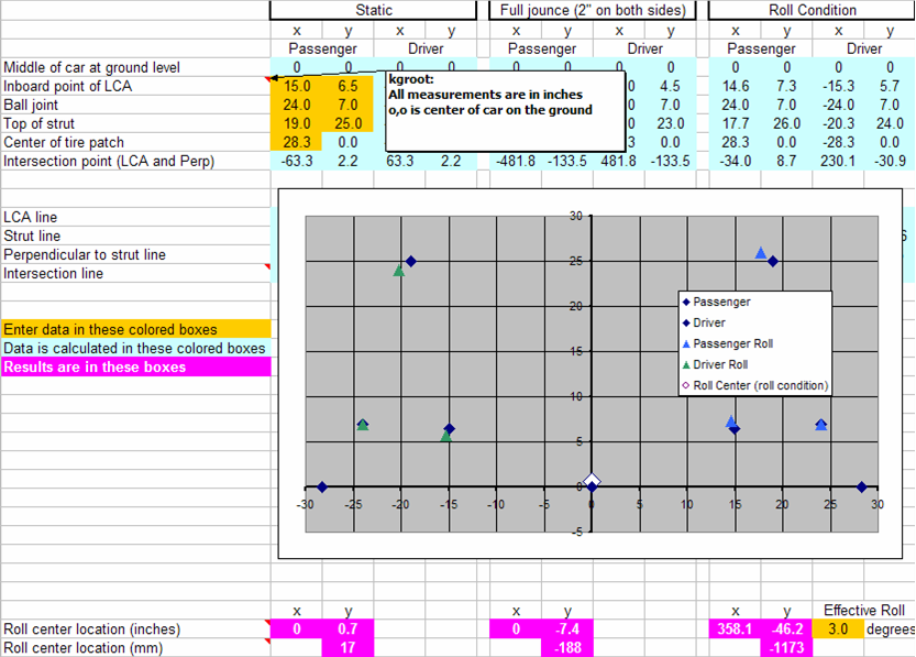

I measured my front and rear motion ratios yesterday and wanted to compare notes with any that have done the same.
For the rear suspension I took ~20 data points and did a best fit analysis to come up with 1.00 to 1.00 damper travel to wheel travel with strong statistical correlation. My front geometry is a bit different than a standard 914, so the motion ratio should be different, too. I measure ~10 points and found 0.83 damper travel to wheel travel, again with strong statistical correlation. I'm about to order my rear shocks and this is one of the bits of data they need to build the shocks. |

groot Here's a simple front roll center calculation ... Dec 1 2004, 07:26 AM

groot Maybe some more explanation would help...
The cha... Dec 1 2004, 08:38 AM
