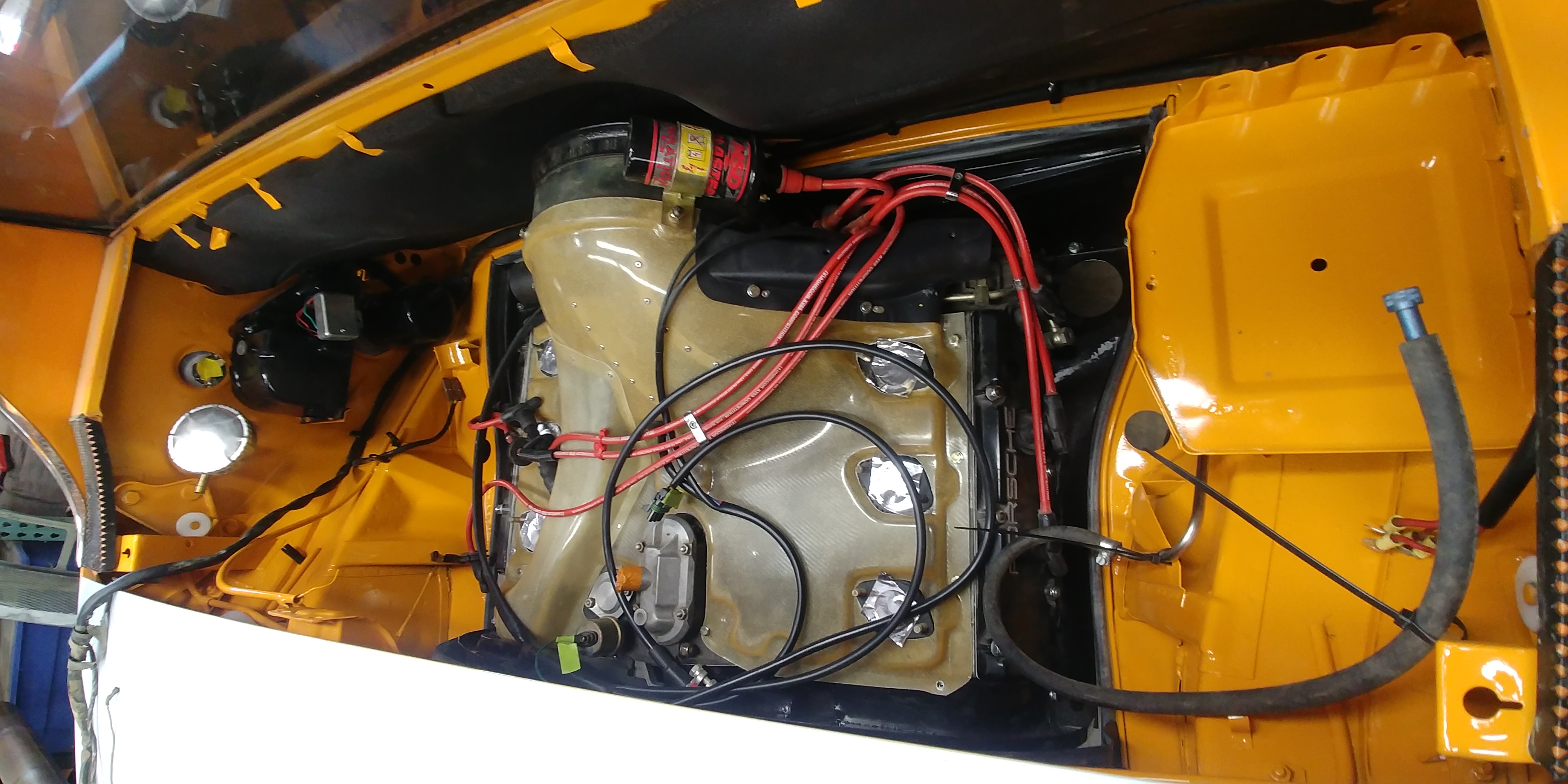

A friend is having me do a -6 conversion and repaint. I will document the swap here.. He has a very nice 2.0 along with very nice ssi heat exchangers he will sell to help fund the project. The car just showed up. Engine drop this week. He already ordered the naro engine mount and a flywheel. I will build him an oil tank and likely send the wiring harness out to Perry if he has time @ironhillsrestorations.. It's a really rust free car so that helps.

Engine in.. Attached Image

mb911   Spent some time drilling holes for the tank and th...   May 5 2019, 08:14 PM
mb911   Engine is here , new clutch, trans rebuilt @914lt...   May 20 2019, 01:23 PM
mb911   Some update pictures.   Jun 11 2019, 05:50 AM
mb911   RE: 74 2.0 to 2.7 swap. It's painted and engine in.   Jun 11 2019, 05:52 AM
Tdskip   Nice work Ben. Is that plastic translucent.   Jun 16 2019, 07:11 AM
mb911   Nice work Ben. Is that plastic translucent. Y...   Jun 16 2019, 07:47 AM
mb911   Underside of the trunk painted.. I just cleaned up...   Jun 21 2019, 07:36 PM
mb911   Engine in..   Jul 13 2019, 10:00 AM
