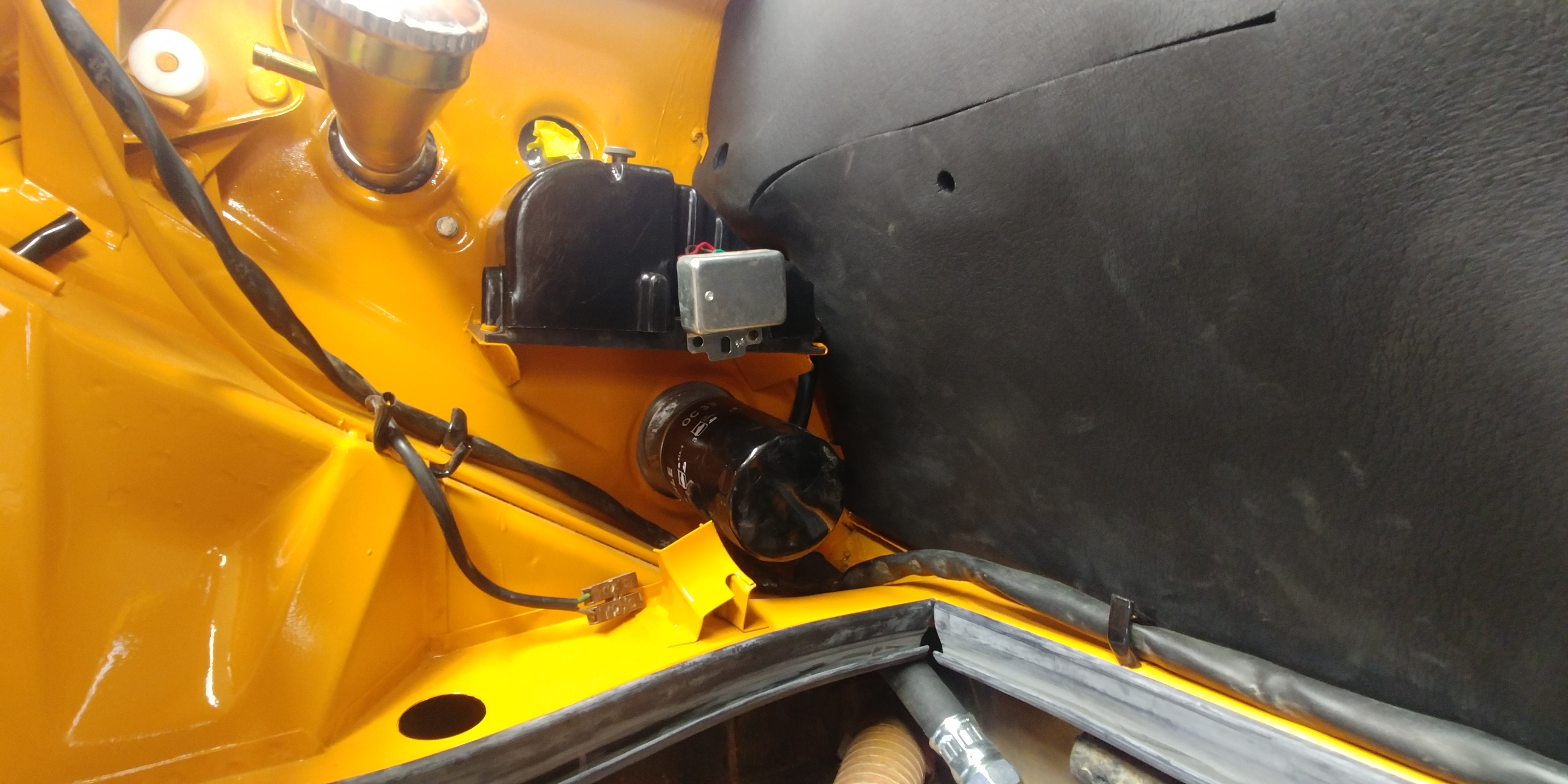

mb911   Spent some time drilling holes for the tank and th...   May 5 2019, 08:14 PM
mb911   Engine is here , new clutch, trans rebuilt @914lt...   May 20 2019, 01:23 PM

Tdskip   Nice work Ben. Is that plastic translucent.   Jun 16 2019, 07:11 AM
mb911   Nice work Ben. Is that plastic translucent. Y...   Jun 16 2019, 07:47 AM
