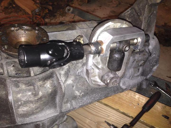

You will be modifying the shift console on the transmission, which is a lot easier to do with the transmission out of the car.
The smart way to do this is to drain the transmission, but I just dammed up the top vents and nothing leaked out.
Once the spherical bushing is in, grease the hell out of it. it is TIGHT against the shifter bar - which it needs to be. Grease will help. I've either gotten used to it, or its broken in a little.
The splined bar going into the console lever was a PITA to get in and indexed properly. Everything has tighter tolerances now.
When I adjusted the shifter, I needed to clearance something (I can't recall what at the moment) where there was an impingement making it difficult going into the 4/5 plane. I know the shift rod was making contact with something, I just can't remember where. I do recall it being easy to remedy once I found it. After I found that, the shifter adjusted easily. For shifter adjustments I used DrEvils notes.
Chris provides templates for making all your cuts and holes that need drilling.
I've got pics of just about everything I've done to this car over the past 15 (holy shit - 15?!) years... Its just a question of finding them. I can find the bearing install but will have to search for (or more likely just reshoot) a pic of the console mod.
(IMG:http://www.914world.com/bbs2/uploads_offsite/live.staticflickr.com-1435-1563286560.1.jpg)
Spherical bearing installed.
if you are on the fence about this product and you have a Rennshifter- don't be. Buy it. I'm glad I did.
One final word - Mike referred to me as a "horrible person" for lopping off the ear of my perfectly fine shifter console. Maybe ask him for a console with a busted ear already before making the mod. But if you don't be sure to take pictures and tag him in them so you get your dose of the Shreck as well. (IMG:style_emoticons/default/beer.gif) (IMG:style_emoticons/default/beerchug.gif) (IMG:style_emoticons/default/beer3.gif)

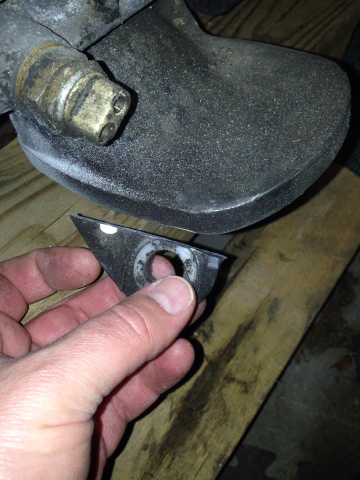

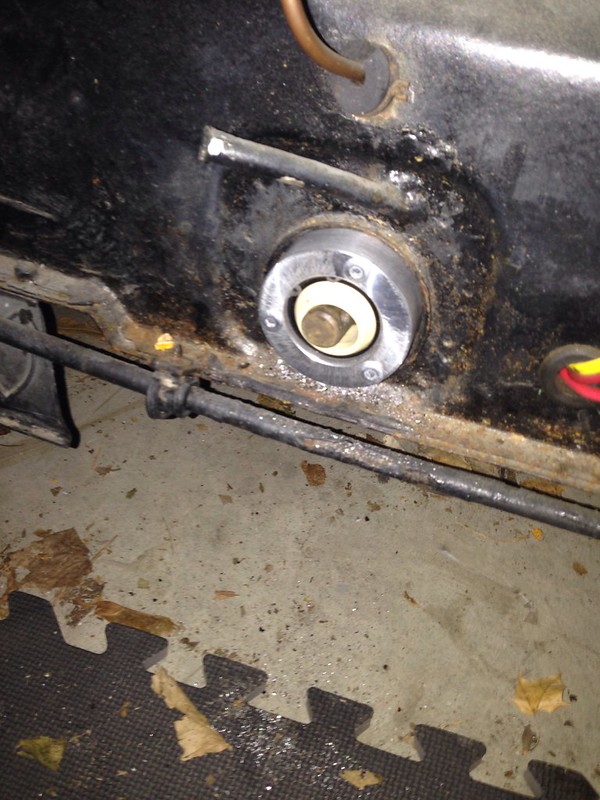

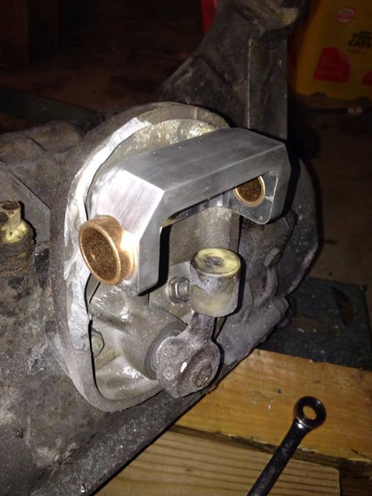

Nope, wasn't that. the rod that was part of the kit was touching (just barely, but just enough) something. If I got under the car to look I'd see it right off, but I'm in AC and the car isn't.
Also, found the pics of my ear mods:
