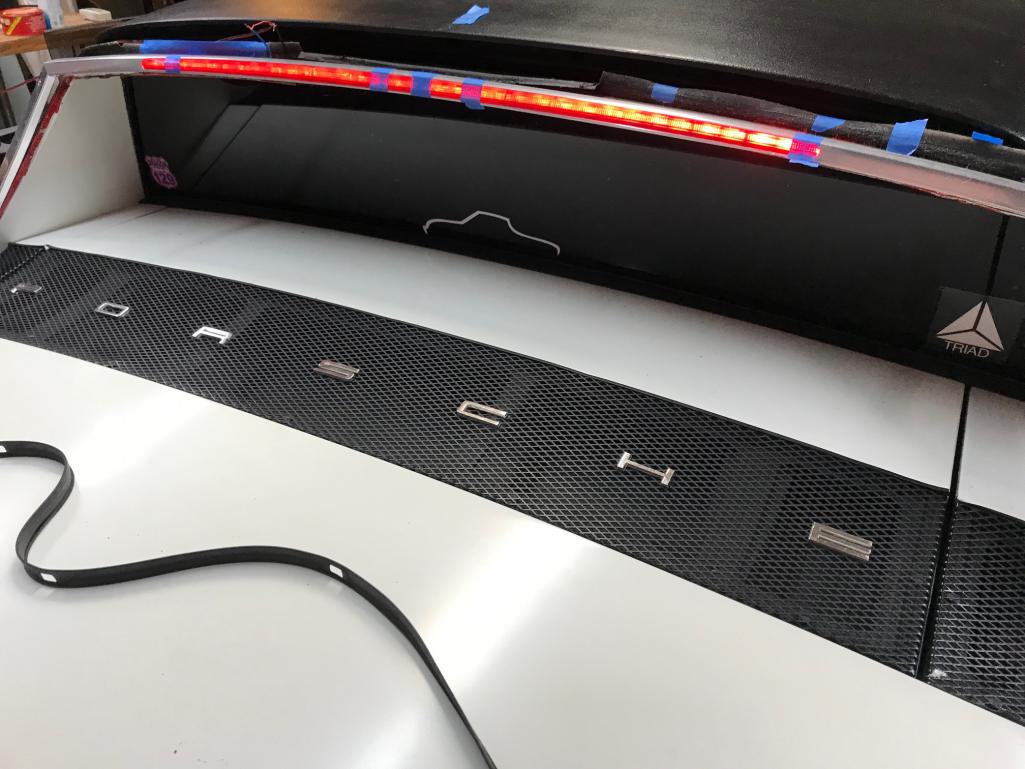

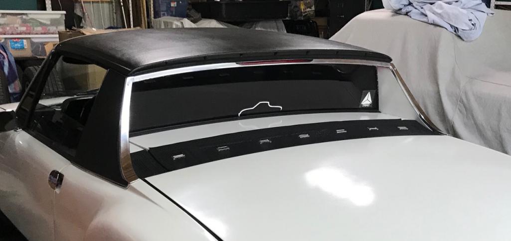

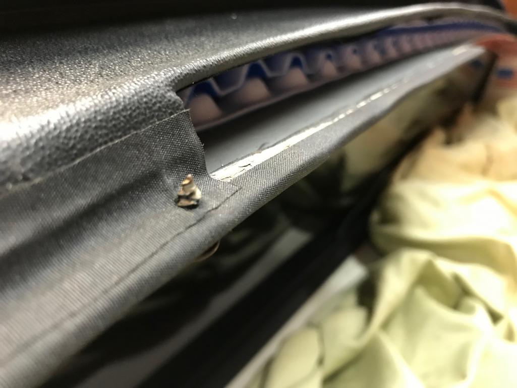

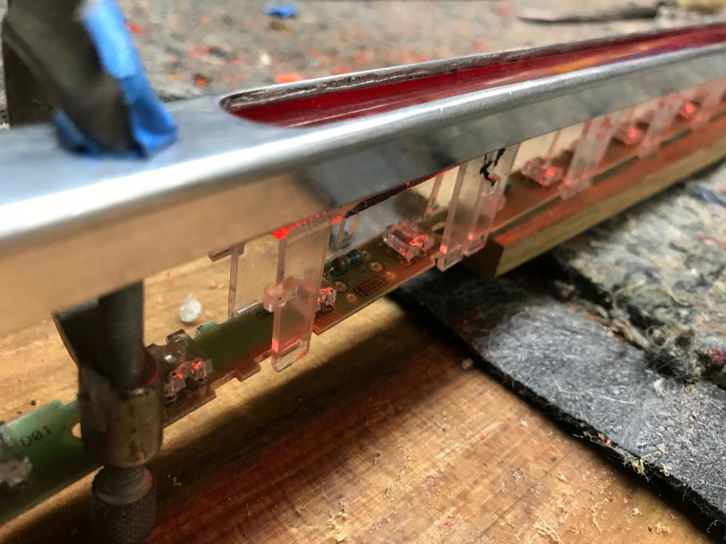

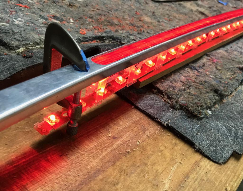

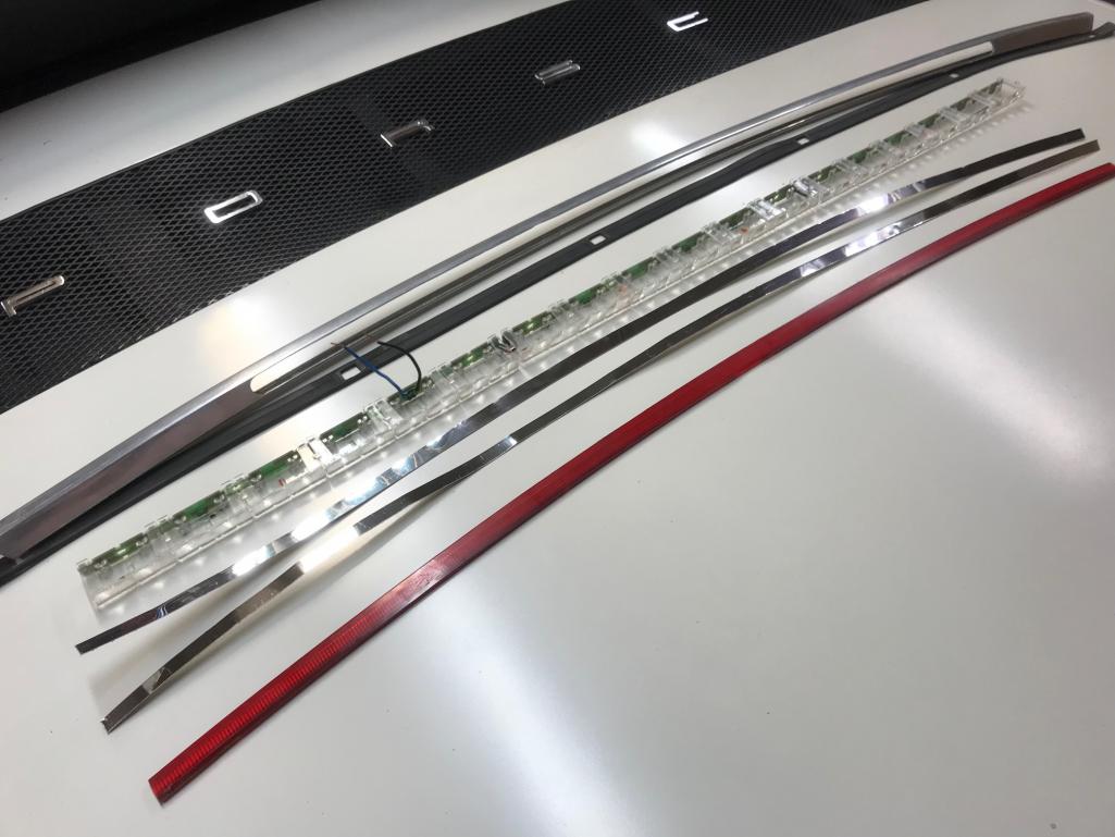

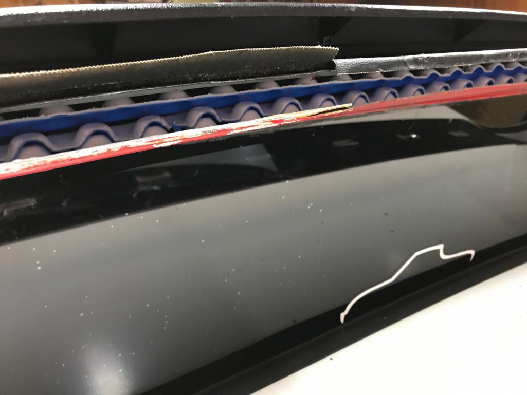

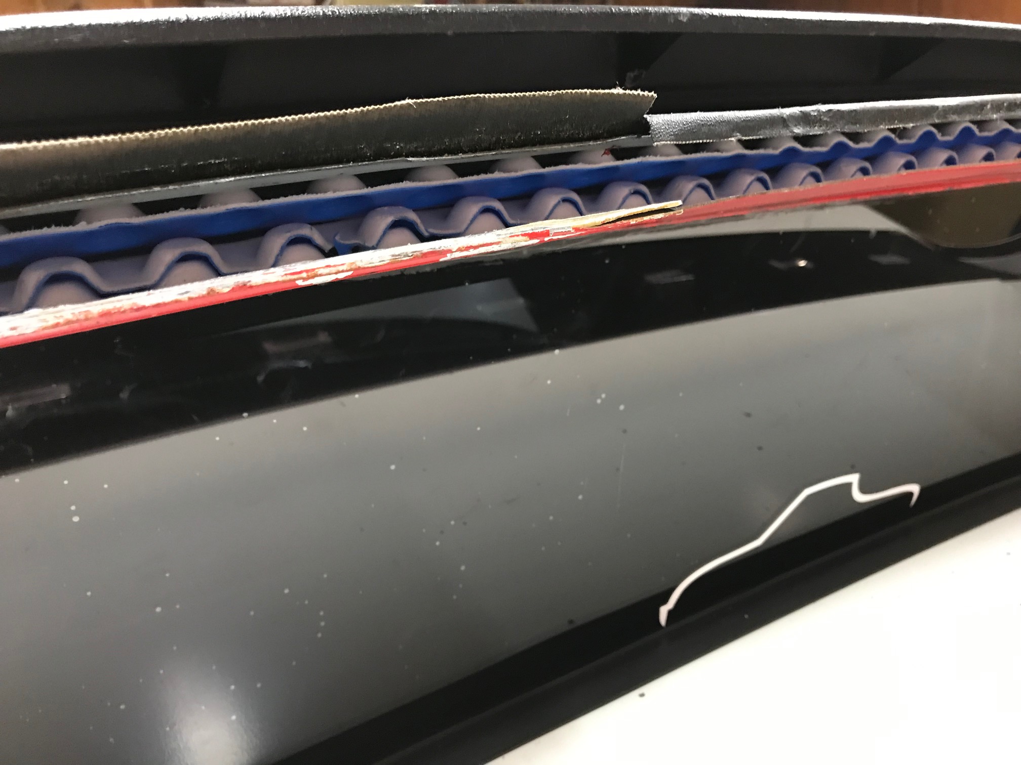

I’ve been wanting to extend the third brake lamp for more width. So this time I’m using the lamp from a Cadillac tailgate . I had to extensively modify the lens size, by filing and sanding it to fit inside the 914 trim. I wanted to reinforce the rollbar and give a backstop to the lamp, so I utilized some underlying material used for floating floors inside the roll bar. It also took quite a bit of time to shave/mill the hole in the roll bar trim.
Also I used the reflective material to get the best performance from the lamp.
Do to do the additional depth needed for the lenses and the style lamp, I needed a little more height, the trim is mounted ontop of the pinch weld, instead of over it. The center section of the pinch weld I removed when installing the other lamp, so a set screw at each end holds the trim in place.
