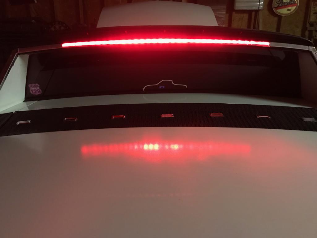

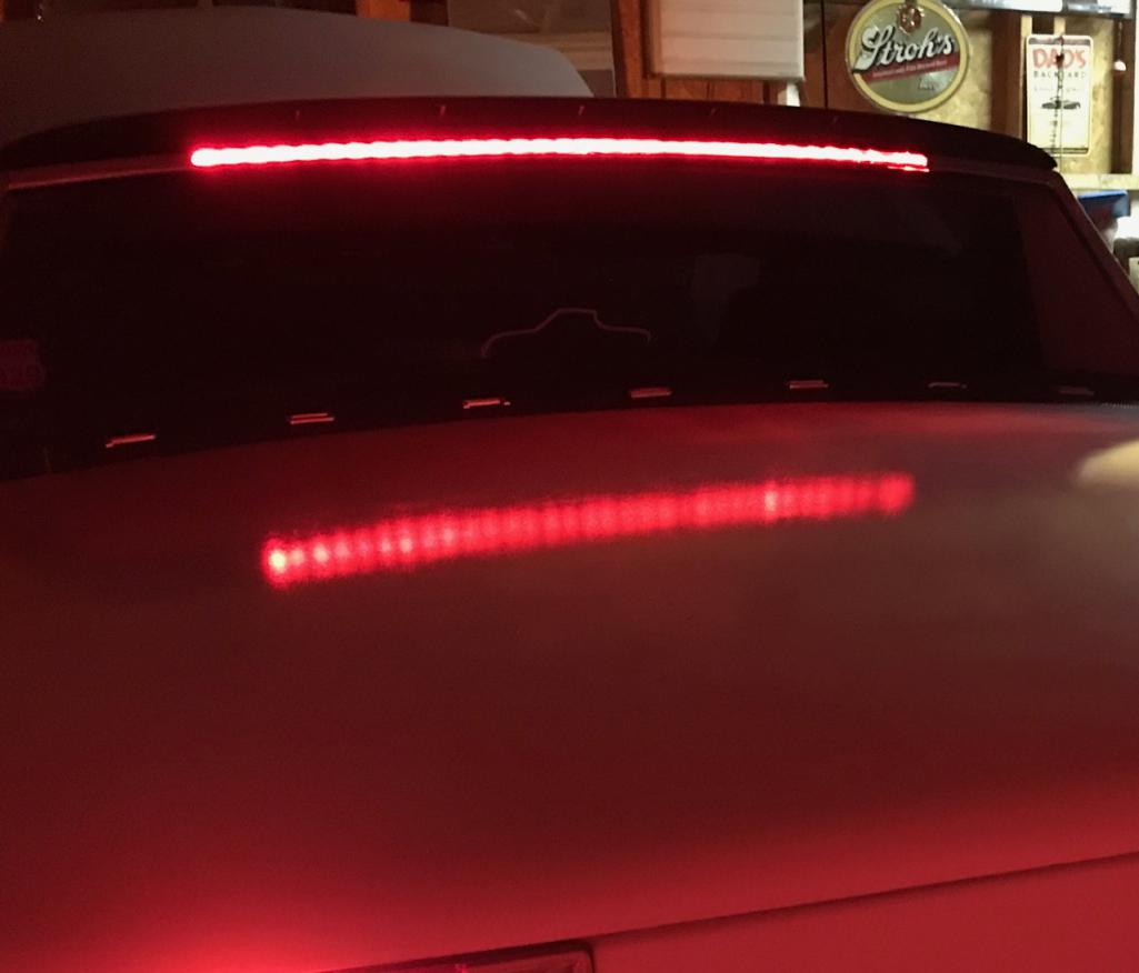

More, and it’s very bright.

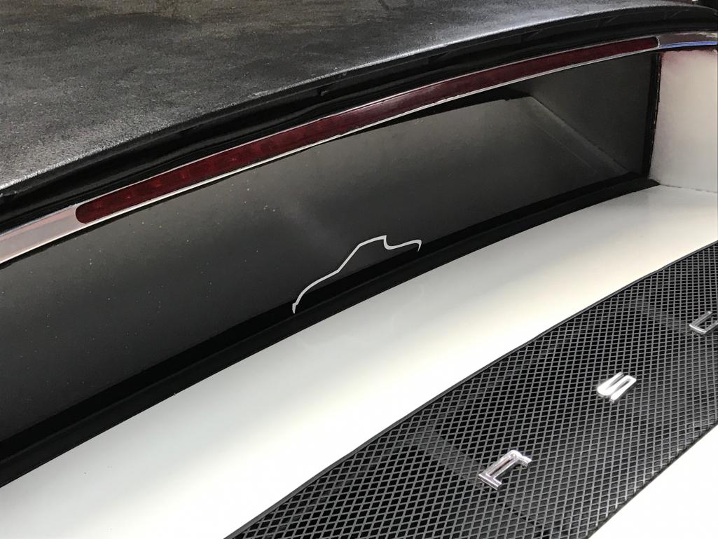

Garland   I’ve been wanting to extend the third brake lamp...   Jul 23 2019, 05:59 PM
Garland   More, and it’s very bright.   Jul 23 2019, 06:03 PM
Tdskip   Very neat installation, well done.   Jul 23 2019, 08:27 PM
euro911   I have a spare crossbar trim piece and plan to do ...   Jul 23 2019, 08:59 PM
Garland   Are used a router bit, in a drill press. It’s a...   Jul 23 2019, 09:42 PM
euro911   That sounds like a good method. Thanks :thumbsup:   Jul 23 2019, 11:58 PM
