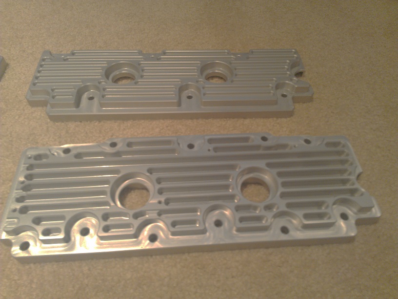

I have a customer who wants to add billet lower valve covers to a 6 conversion. He had one machine shop botch the first pair. Anybody done this and know how much material needs to be removed to clear the suspension point? I drawing showing the area to machined and the finished thickness would be ideal.

If you are not hung up on the O.E. look I highly recommend these Hargett Precision billet covers, they utilize the later 964 type cord seal. This ended years of leaks on my 914.

Don't use the factory 964 valve covers. They are thin magnesium and warp easily causing a hell of a leak. If you are using twin plug heads, use these
They are billet aluminum, and they use the stock seal. I have been told they won't leak like the factory ones. I have not tried it, so you may find you have to enlarge the bolt holes. The 964 uses 6x1.0 studs, the older engines use 8x1.25 studs.
