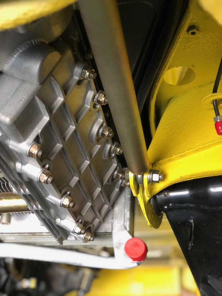

What I have on my 6 #41Attached Image

burton73   What I have on my 6 #41 Bob B   Aug 6 2019, 09:32 PM
