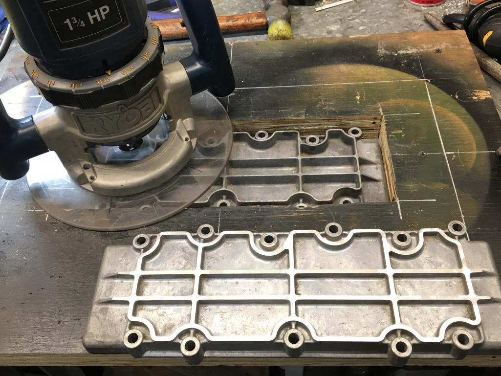

I have a customer who wants to add billet lower valve covers to a 6 conversion. He had one machine shop botch the first pair. Anybody done this and know how much material needs to be removed to clear the suspension point? I drawing showing the area to machined and the finished thickness would be ideal.

I milled mine down to just above the bosses using a router w/carbide bit ....

mepstein   scotty b did mine at his local shop. 5/16". I...   Sep 18 2015, 10:26 AM

mepstein   heres what scotty did.   Sep 18 2015, 11:08 AM
