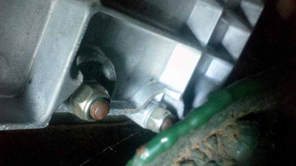

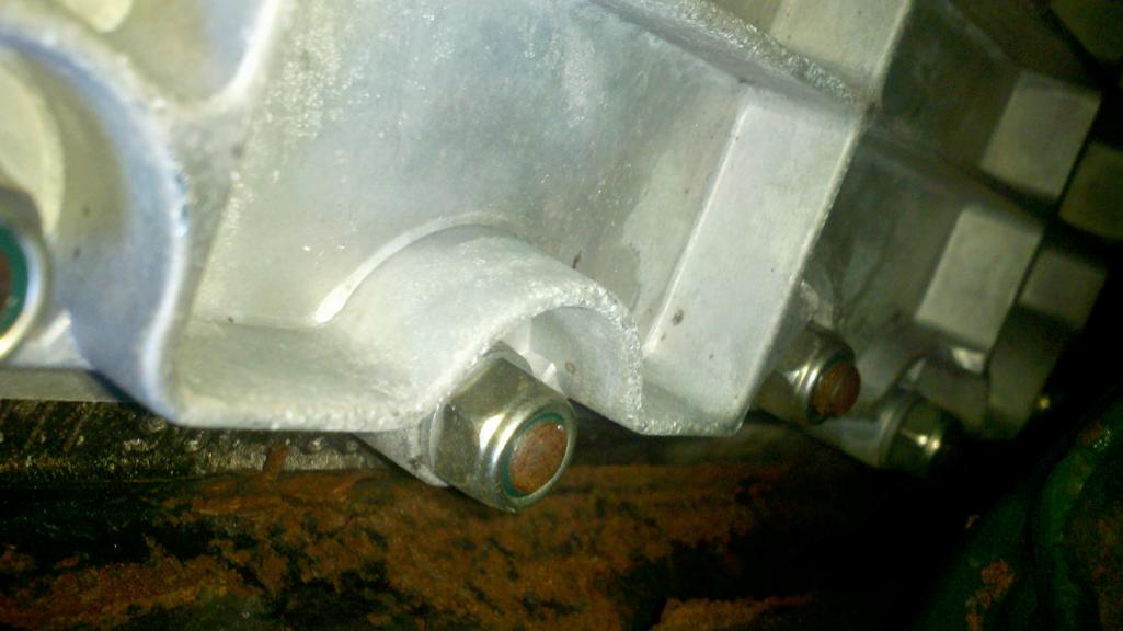

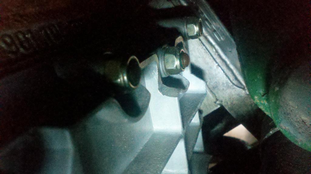

fixer34
post Aug 9 2019, 08:38 PM
Posts: 1,463
Joined: 16-September 14
From: Chicago area
Member No.: 17,908
Been there, done that 5+ years ago when I replaced leaky magnesium covers (with engine in the car). Sales rep told me the turbo covers would fit as-is. Manager later called to apologize. Here are some pictures I took best I could after my 'modifications'. Don't need to take much off, just around a couple bosses.Attached Image Attached ImageAttached Image
