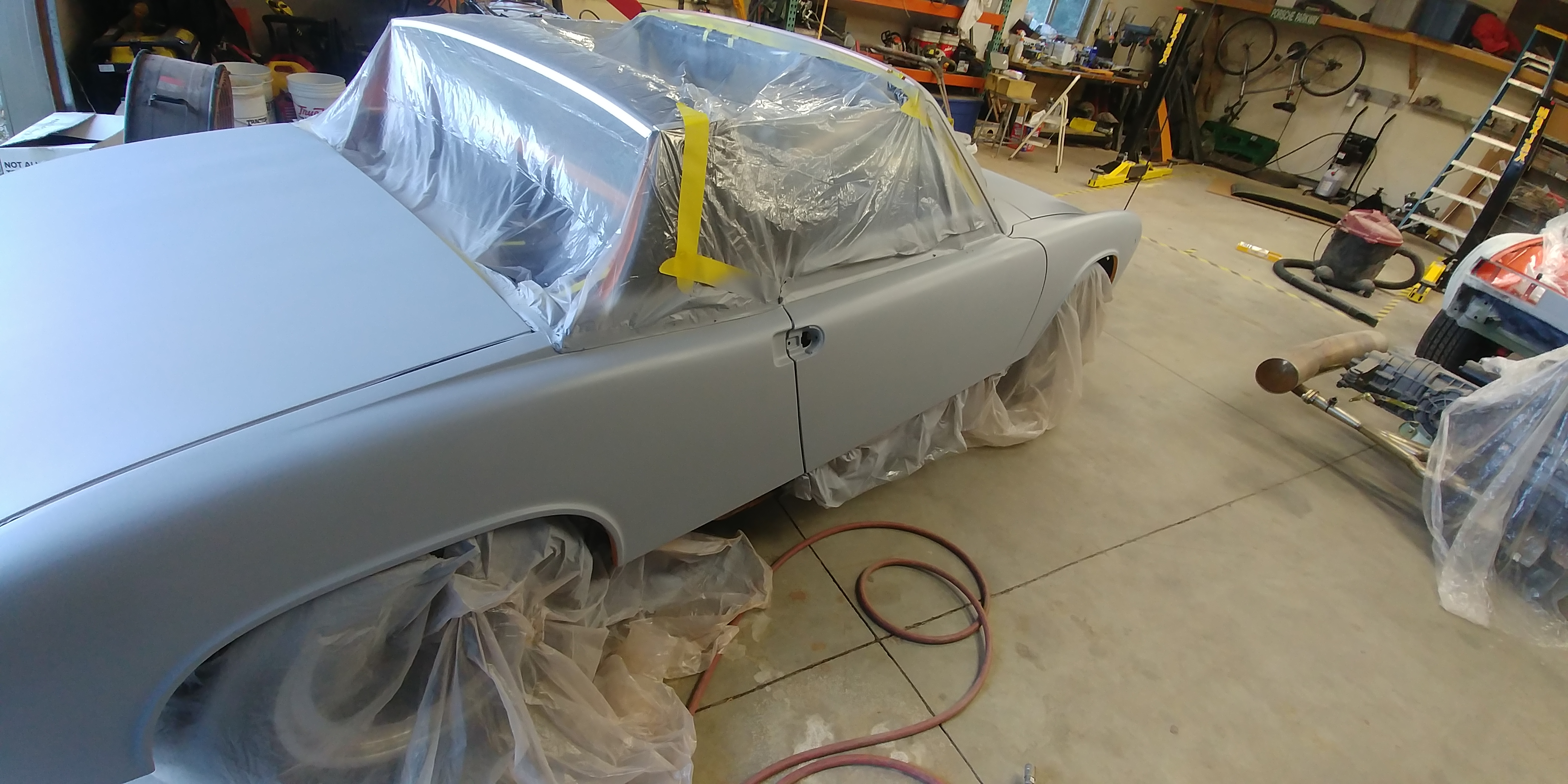

A friend is having me do a -6 conversion and repaint. I will document the swap here.. He has a very nice 2.0 along with very nice ssi heat exchangers he will sell to help fund the project. The car just showed up. Engine drop this week. He already ordered the naro engine mount and a flywheel. I will build him an oil tank and likely send the wiring harness out to Perry if he has time @ironhillsrestorations.. It's a really rust free car so that helps.

Blocked then sprayed 3 coats of primer surfacer.. Then sit and do any shrinking.. Will block this week and then a once over next week before paint. Attached Image
