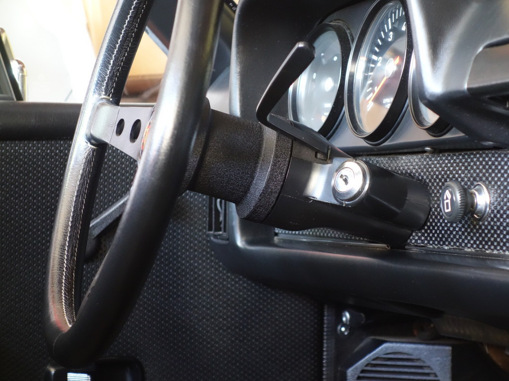

raynekat   The hub adapter kit showed up today from Classicga...   Oct 31 2019, 04:16 PM
sixnotfour   Idea; encapsulate the plunger in epoxy in the corr...   Nov 1 2019, 10:25 AM
raynekat   Idea; encapsulate the plunger in epoxy in the cor...   Nov 1 2019, 01:44 PM
horizontally-opposed   It doesn't look like the old Momo hub would be...   Nov 1 2019, 03:42 PM
sithot   It doesn't look like the old Momo hub would b...   Nov 2 2019, 07:13 AM
horizontally-opposed   It doesn't look like the old Momo hub would ...   Nov 6 2019, 04:14 PM

raynekat   So here's the problem with the Luisi hub. It a...   Nov 6 2019, 10:10 PM
raynekat   As compared to the factory wheel/hub which has it...   Nov 6 2019, 10:11 PM
raynekat   Well it is a problem when you consider the horn ri...   Nov 6 2019, 10:17 PM
infraredcalvin   How about moving the screws outward and filling t...   Nov 6 2019, 10:29 PM
sixnotfour   :sawzall:   Nov 7 2019, 09:02 AM

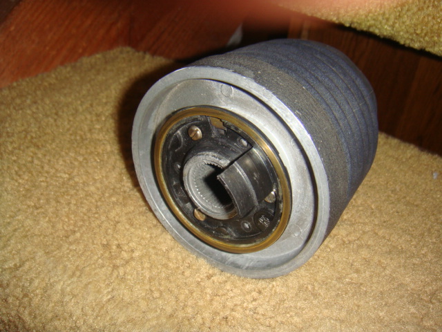

raynekat   Gave up on the Luisi hub. It's not going to fi...   Nov 17 2019, 11:09 PM
raynekat   Momo 8000 hub attached to my Momo Prototipo.   Nov 17 2019, 11:10 PM
raynekat   This is the type of Momo horn button I have. Has t...   Nov 17 2019, 11:16 PM
sixnotfour   wow 8000 where you just lucky or is there a source...   Nov 18 2019, 12:08 AM
raynekat   wow 8000 where you just lucky or is there a sourc...   Nov 18 2019, 04:22 PM

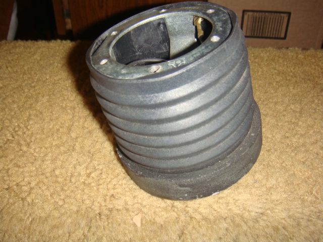

sb914   this is one I have for comparison. Looks the same...   Nov 18 2019, 06:55 AM

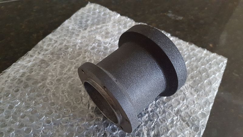

raynekat   Update from Luisi. I sent my first Luisi hub back...   Jan 3 2020, 03:30 PM
sixnotfour   Super Good IIntell…..great vendor response...   Jan 3 2020, 04:48 PM
raynekat   So the vendor is sourcing this new design from Lui...   Jan 3 2020, 09:54 PM
