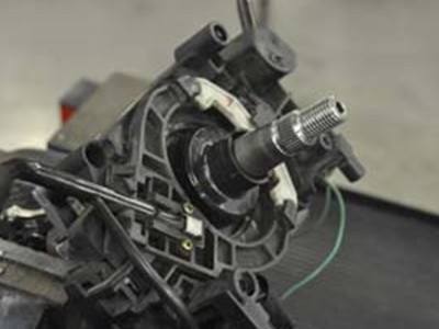

Having already received one Momo solid hub that wouldn't go on the steering shaft, on the recommendation of a gent who I buy tools and custom Porsche parts from I tried Amazon for what was purported to be a MOMO 8002 solid hub.
What showed up from "LTB Autosports" turned out NOT TO BE a solid hub as advertised.
Anyone can plainly see from the measurements this one wouldn't ever work regardless of configuation.
Before I raise the white flag I'm open to suggestions. Jimmy Tidwell made some of these at one time but as the market was covered he prefers to make things you cannot easily buy.
OTOH, Ive got a half dozen cool period wheels looking for a car. (IMG:style_emoticons/default/chowtime.gif)
Thanks
Tom
PS: Box is marked 89-97 Mazda Miata but also has a MOMO 8002 sticker "for Porsche" on it.

send it back ,,,,
#1 the one they sent is not a solid hub .
#2 miata and 914....2 different cars period.
8002 is the correct #.. I doubt they have a soild one in stock .
hit up @Chi-town
I have a used momo solid hub for late if that's the one you end up needing.

sithot   Here you go: Thanks! Tom   Aug 16 2019, 02:15 PM
raynekat   This looks identical to my shaft on my 71 914-4. E...   Oct 23 2019, 10:59 PM

raynekat   First....what year is your 914? Looking at this s...   Oct 23 2019, 10:50 PM
sixnotfour   If you have a 70-71 914,, with the a 70-71 column,...   Oct 24 2019, 01:39 AM
