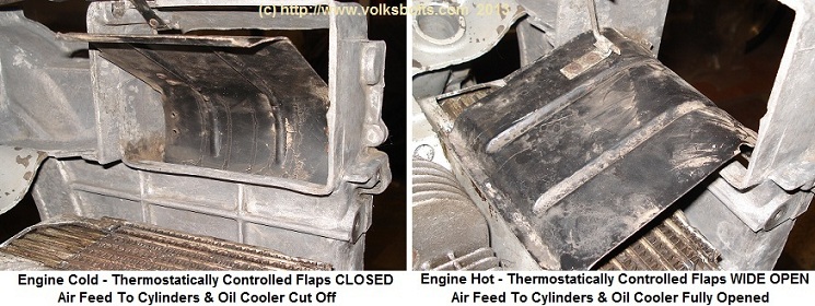

Did you scope the oil cooler to ensure that it was not caked over with mouse stuff or crusty oil?
I agree on the absence of oil flaps contributing to overheating. if you examine the photo you will not even though it looks like the oil cooler is covered, the extension of the flap in to the air stream forces a huge amount of air on to the oil cooler.
Without it the air follows the path of least resistance and goes to the cylinders and very little to the cooler.
Not a good situation for effective cooling!
