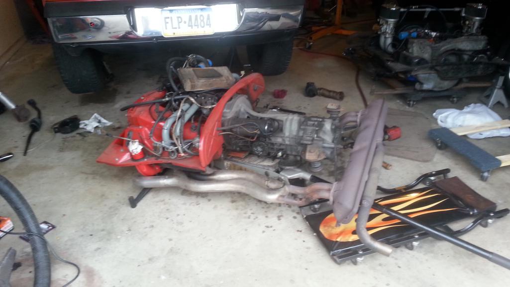

You need to drop the engine. You have enough stuff going on that trying to work on it with the engine in it's little cocoon is an absolute nightmare. Once you drop the engine you'll understand why everyone is saying to do it.
The worst part about dropping the engine is thinking about it. Once out, everything is at your fingertips. You can clean the critter nests out, degrease, repair/replace the cooling tins, repaint/powdercoat the tins. Also doing a valve adjustment on the engine out is a breeze.
I've dropped the engine twice in my 914 and both times by myself. The biggest pain in the ass as far as I'm concerned are the CV joints. When disconnecting them from the transmission now the actual CVs are open and that grease can get on everything.
If any of the heating tubes under the car are missing this would be a good time to install them. Are all the tubes in place? Do you have heat exchangers?
