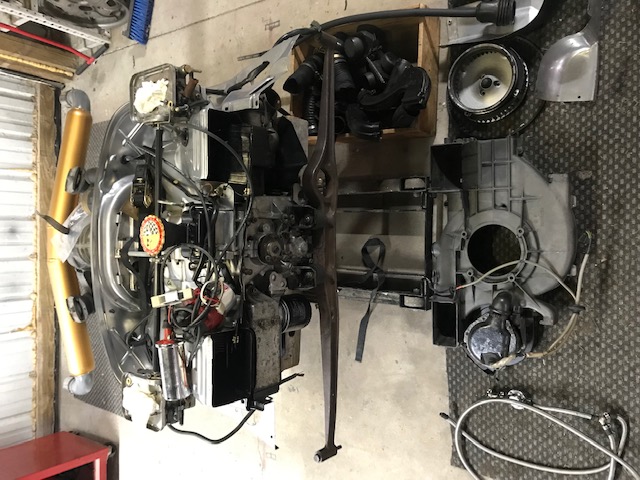

Here’s a shot with the shroud and heater tins removed.
