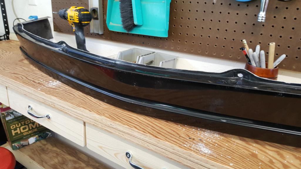

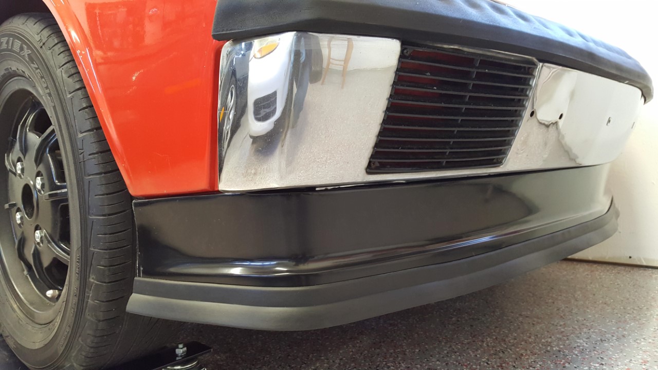

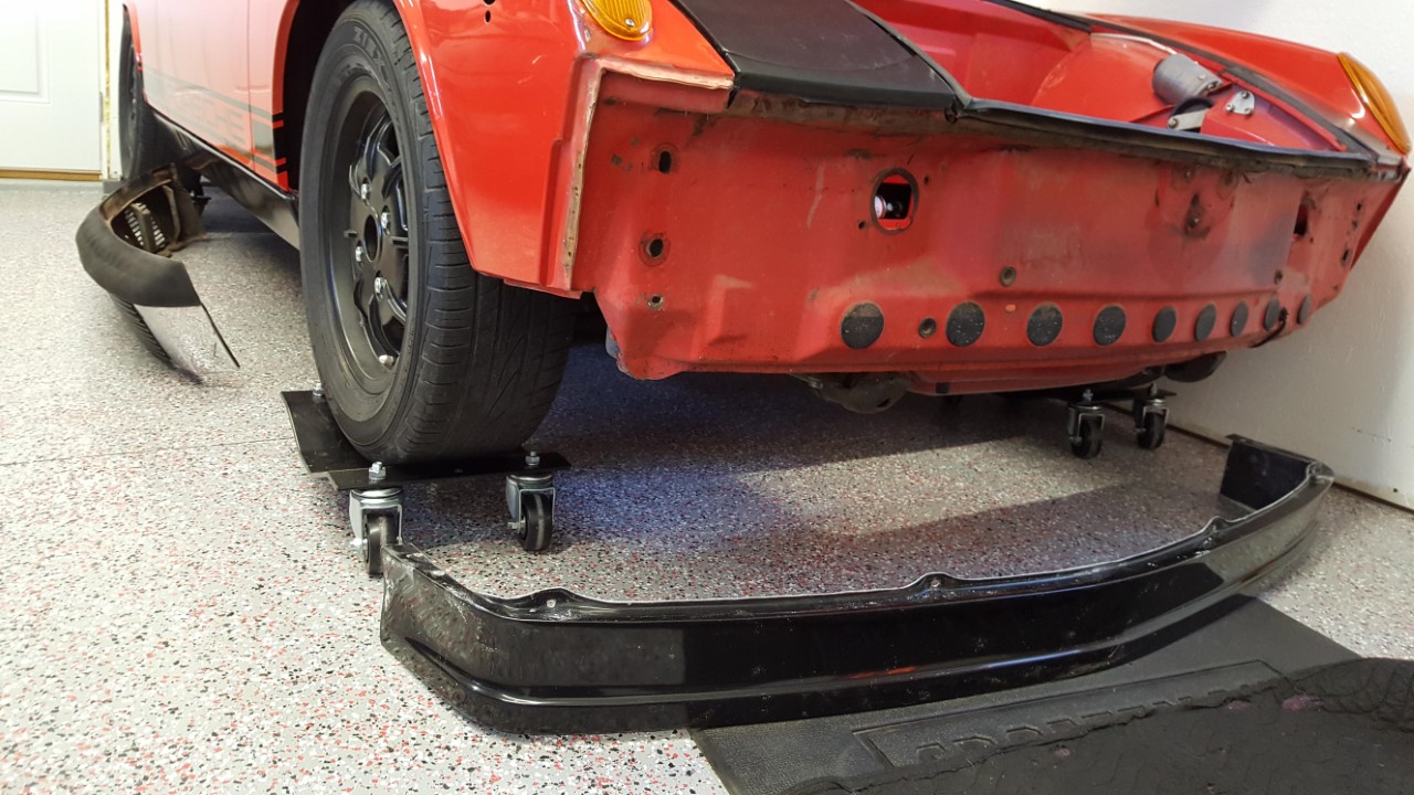

In the time I've owned the car, it's never had a front valance, leaving it looking pretty bare and unfinished. A front airdam/spoiler from 914Rubber solved that, and a universal rubber lip from eBay visually lowered things a bit more:
More to come...
