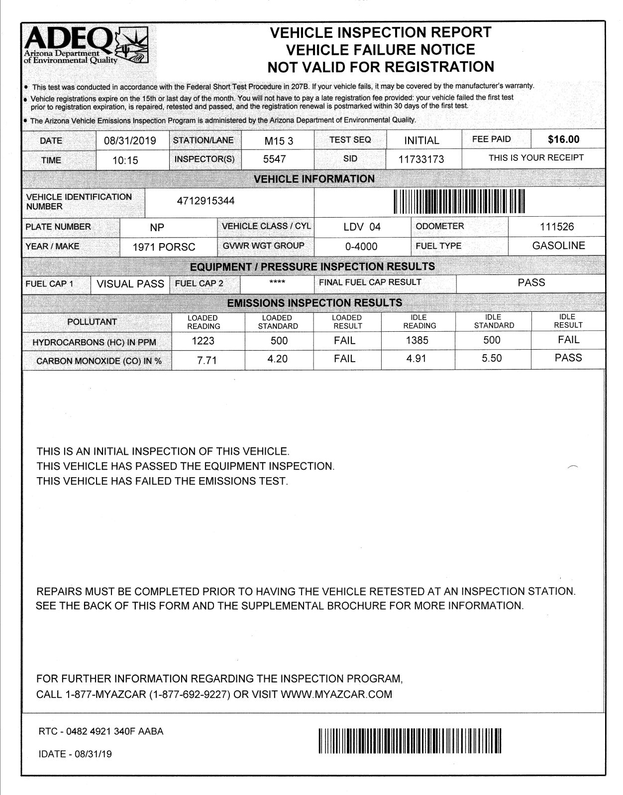

Emissions result from Saturday
JOEPROPER
post Sep 5 2019, 08:04 AM
The answer is "no" unless you ask...
Posts: 1,209
Joined: 21-November 15
From: White Plains New York
Member No.: 19,387
QUOTE(AZBanks @ Sep 5 2019, 01:06 AM) *
Running rich... CO is rich/lean indicator and high HC indicates misfire / unburned fuel.
