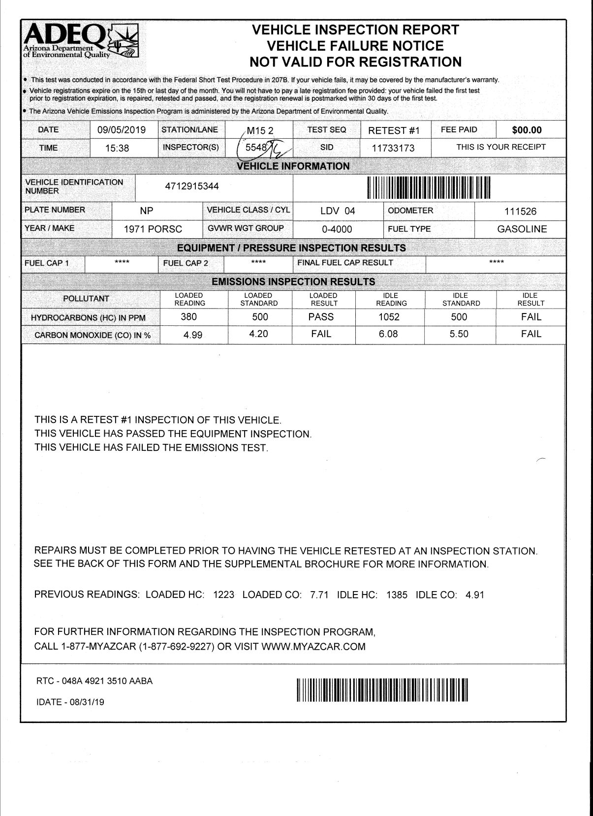

AZBanks   Working on a tune-up. Trying to get it to pass emi...   Sep 4 2019, 10:28 PM
ndfrigi   Working on a tune-up. Trying to get it to pass em...   Sep 4 2019, 10:36 PM
AZBanks   Emissions result from Saturday   Sep 4 2019, 11:06 PM
michael7810   Emissions result from Saturday You probably know...   Sep 5 2019, 06:38 AM
VaccaRabite   Emissions result from Saturday You probably kno...   Sep 5 2019, 07:51 AM
michael7810   [quote name='michael7810' post='2744213' date='Se...   Sep 5 2019, 09:16 AM
JOEPROPER   Emissions result from Saturday Running rich... ...   Sep 5 2019, 08:04 AM

AZBanks   If I don't get it to pass emissions today, I a...   Sep 5 2019, 02:48 PM
AZBanks   Improved in some areas, got worse in others. I am...   Sep 5 2019, 07:29 PM

michael7810   If you have Weber’s there is a good chance an id...   Sep 20 2019, 05:32 PM
AZBanks   We still have some tuning to do but we got it clea...   Sep 21 2019, 03:57 PM
