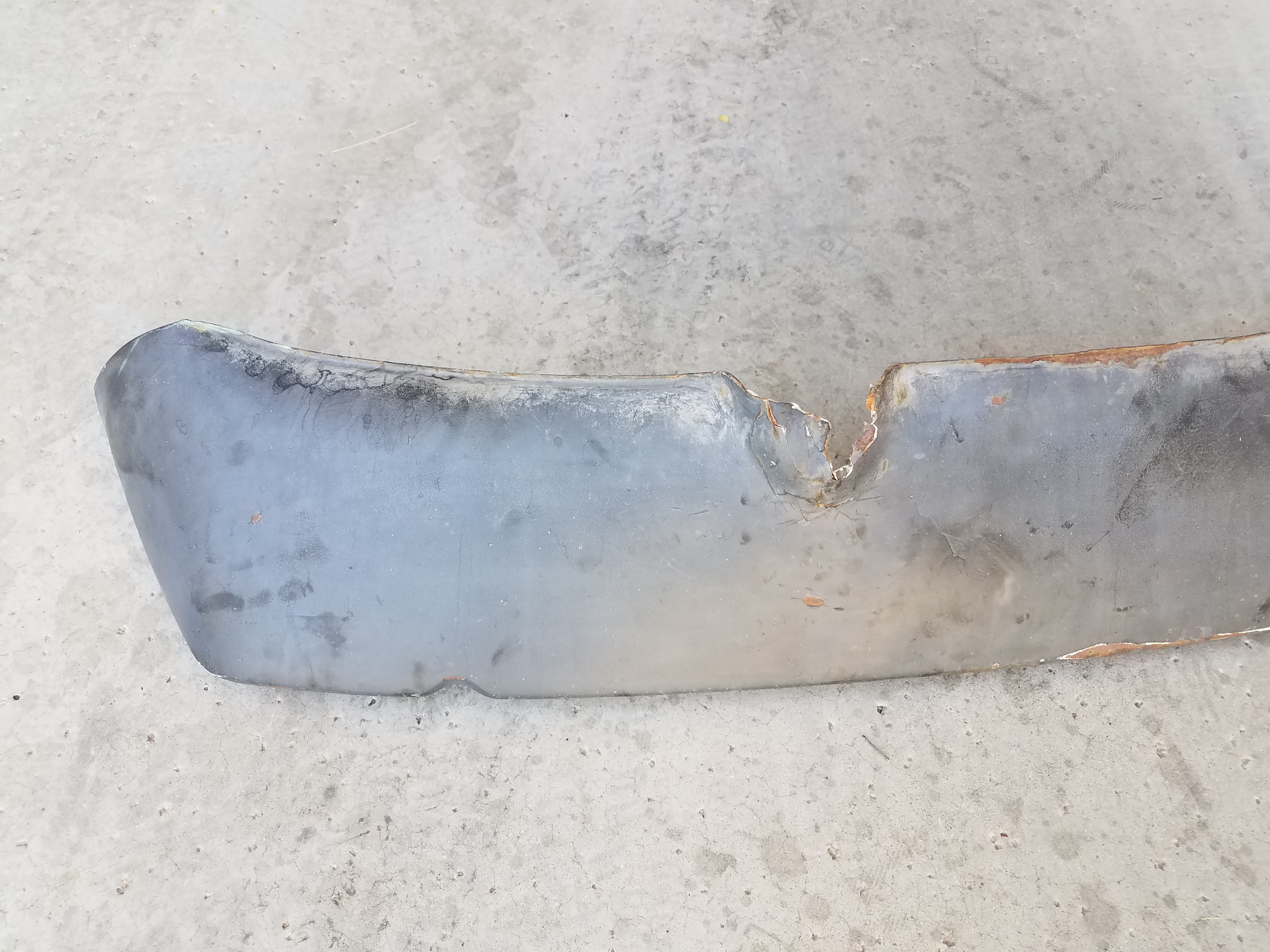

AZBanks   I would like to petition the Arizona Department of...   Sep 6 2019, 11:23 AM
AZBanks   I don't know if it was the same PO but someone...   Sep 6 2019, 11:27 AM
AZBanks   Worst side of the valance.   Sep 6 2019, 11:28 AM
AZBanks   Close up after I removed most of the body filler a...   Sep 6 2019, 11:28 AM
AZBanks   Back side of valance damage.   Sep 6 2019, 11:30 AM
AZBanks   Other end of valance.   Sep 6 2019, 11:31 AM
AZBanks   Back side of other end.   Sep 6 2019, 11:32 AM
Coondog   Those are easy to replace and cheap. Save your ang...   Sep 6 2019, 12:35 PM
