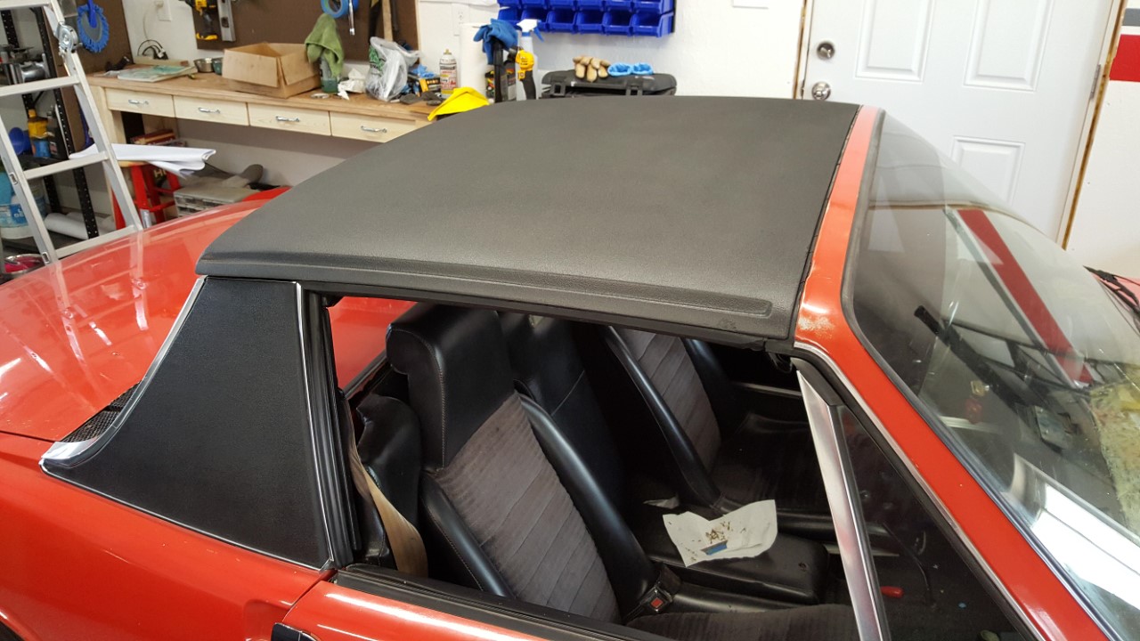

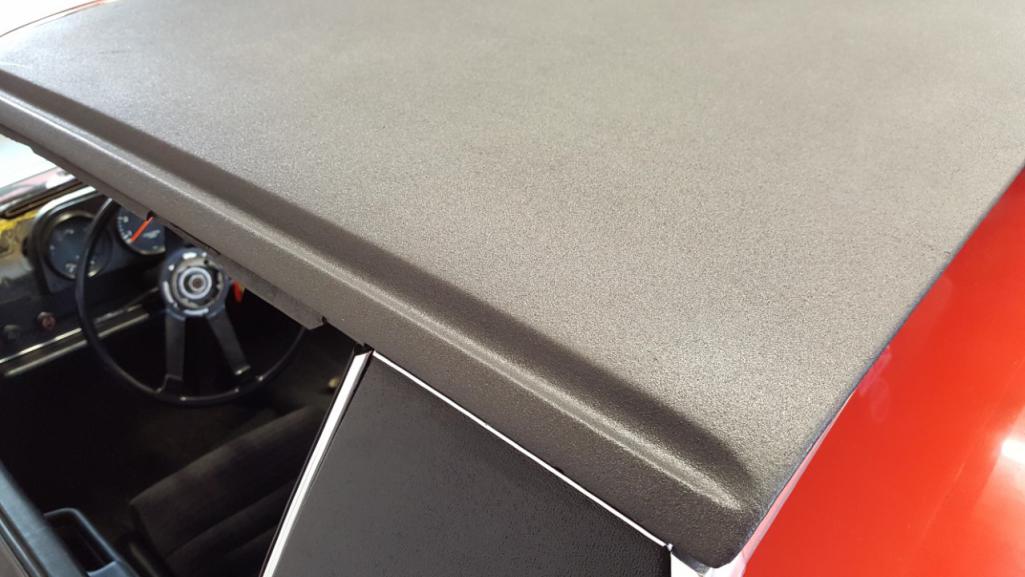

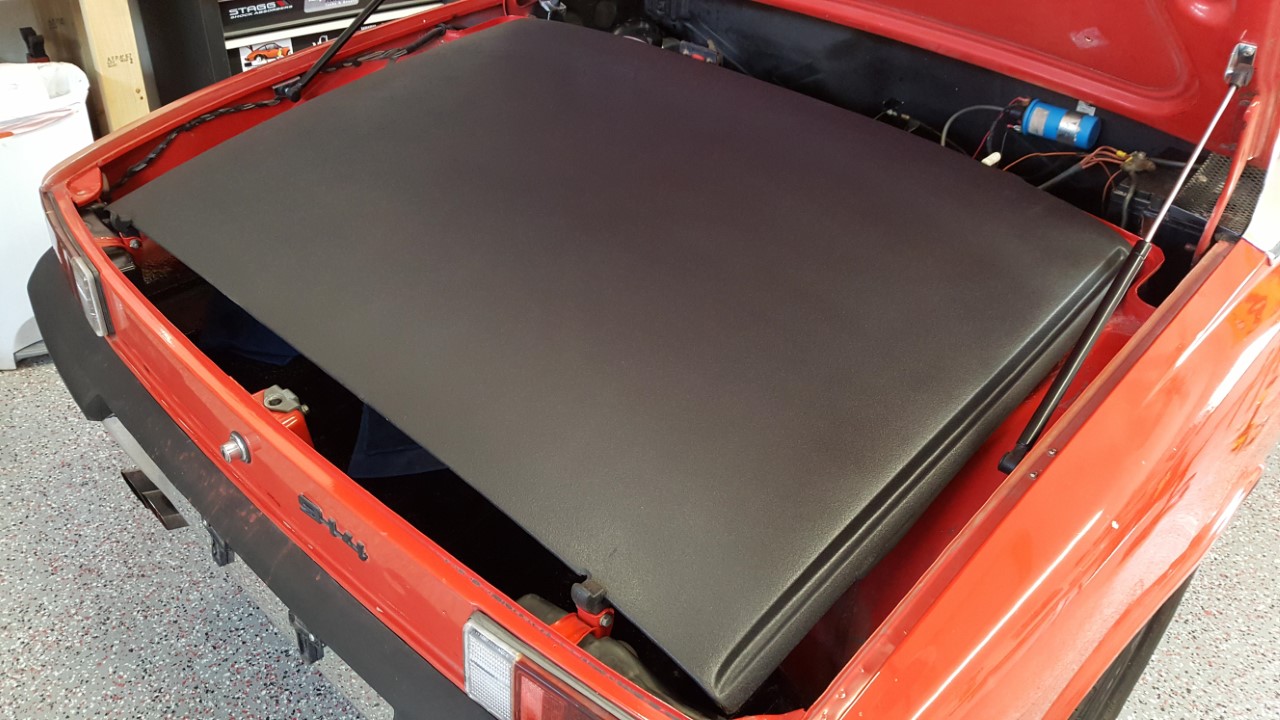

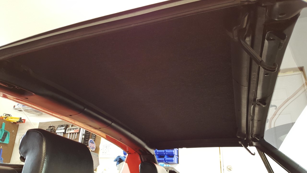

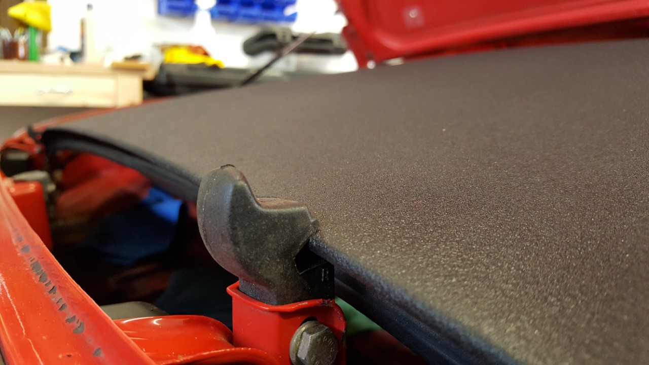

The targa top was in pretty solid shape, but faded and discolored from the New Mexico sun (like everything else on the car!). I tried some Duplicolor Rocker Guard, which I think worked pretty well. I also re-glued the sagging headliner.

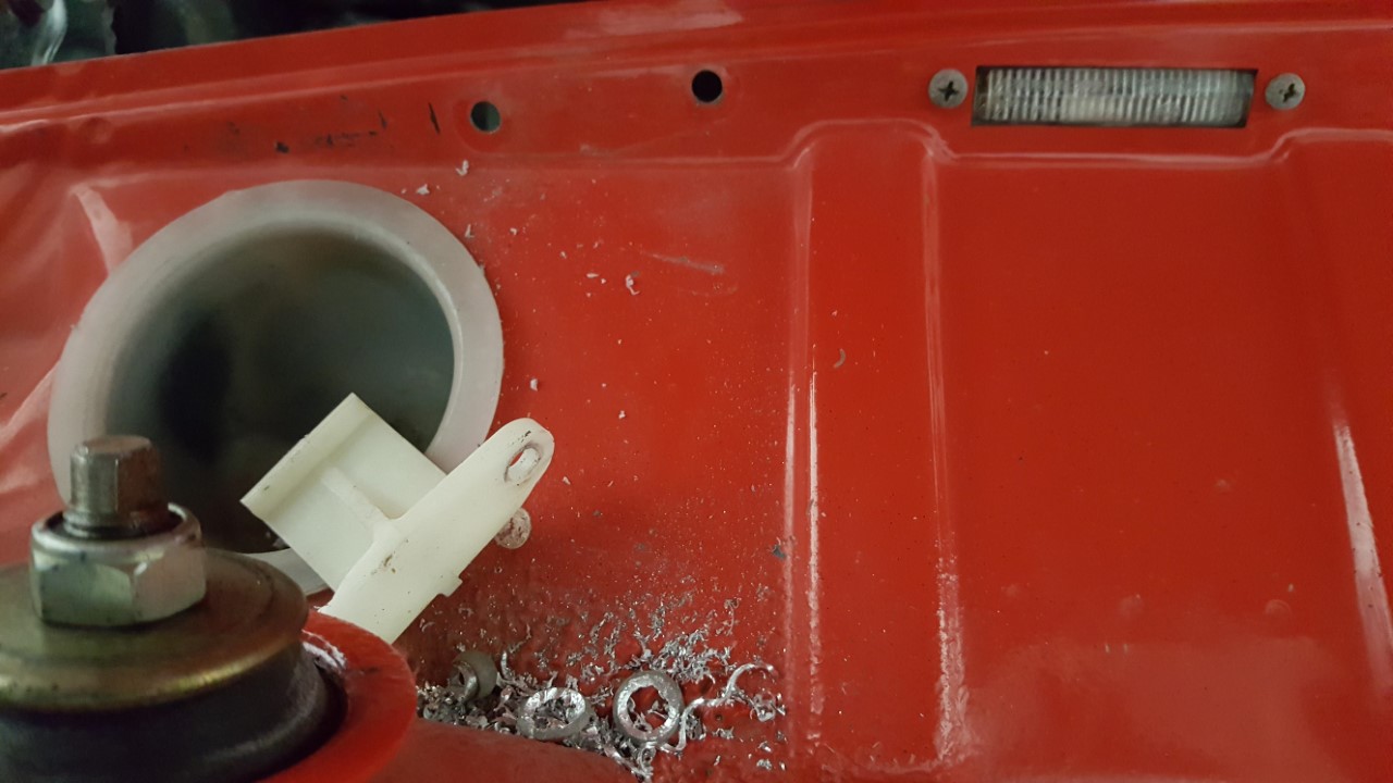

The targa storage clips were in rough shape, with the white plastic ones to the front broken and the rubber ones to rear torn. I rummaged around through the spare parts that came with the car and found some good white clips. I had to drilled out the rivets on the old ones. Then I ordered a few new rubber clips. Now the good looking top can be securely stowed. Having lived through the "charm" of other vintage convertibles, I love the 914 targa design!
