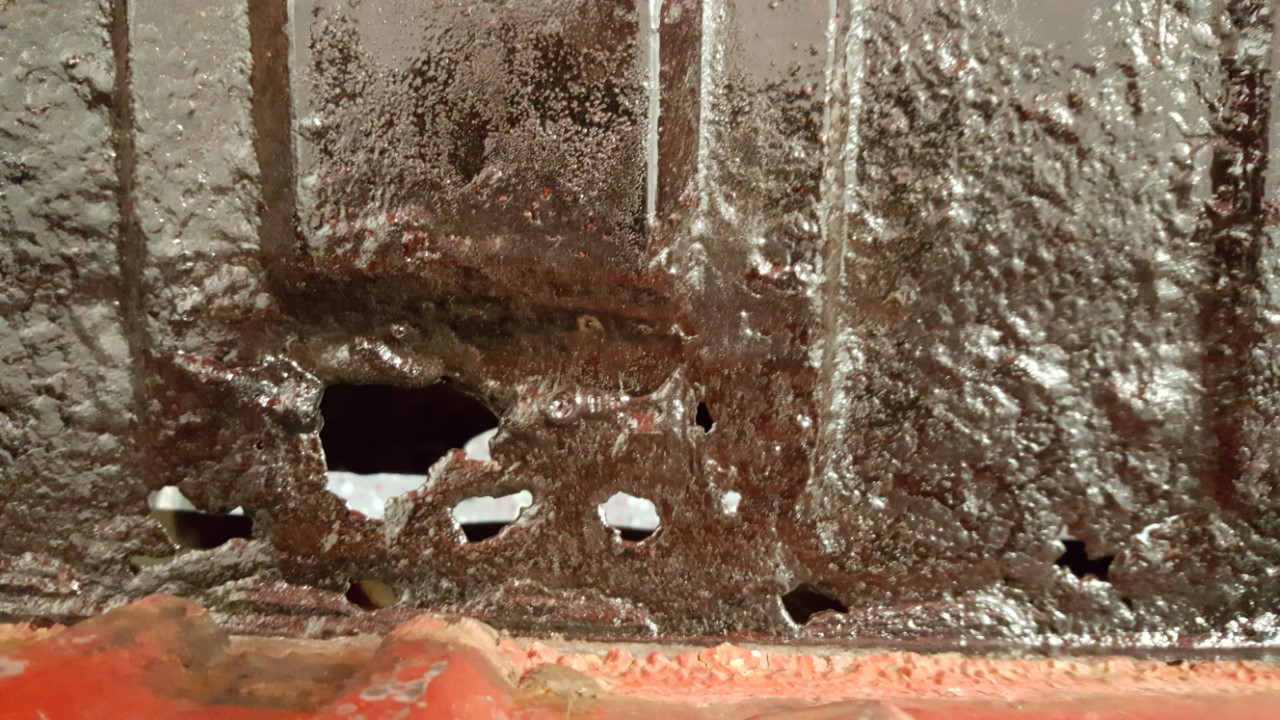

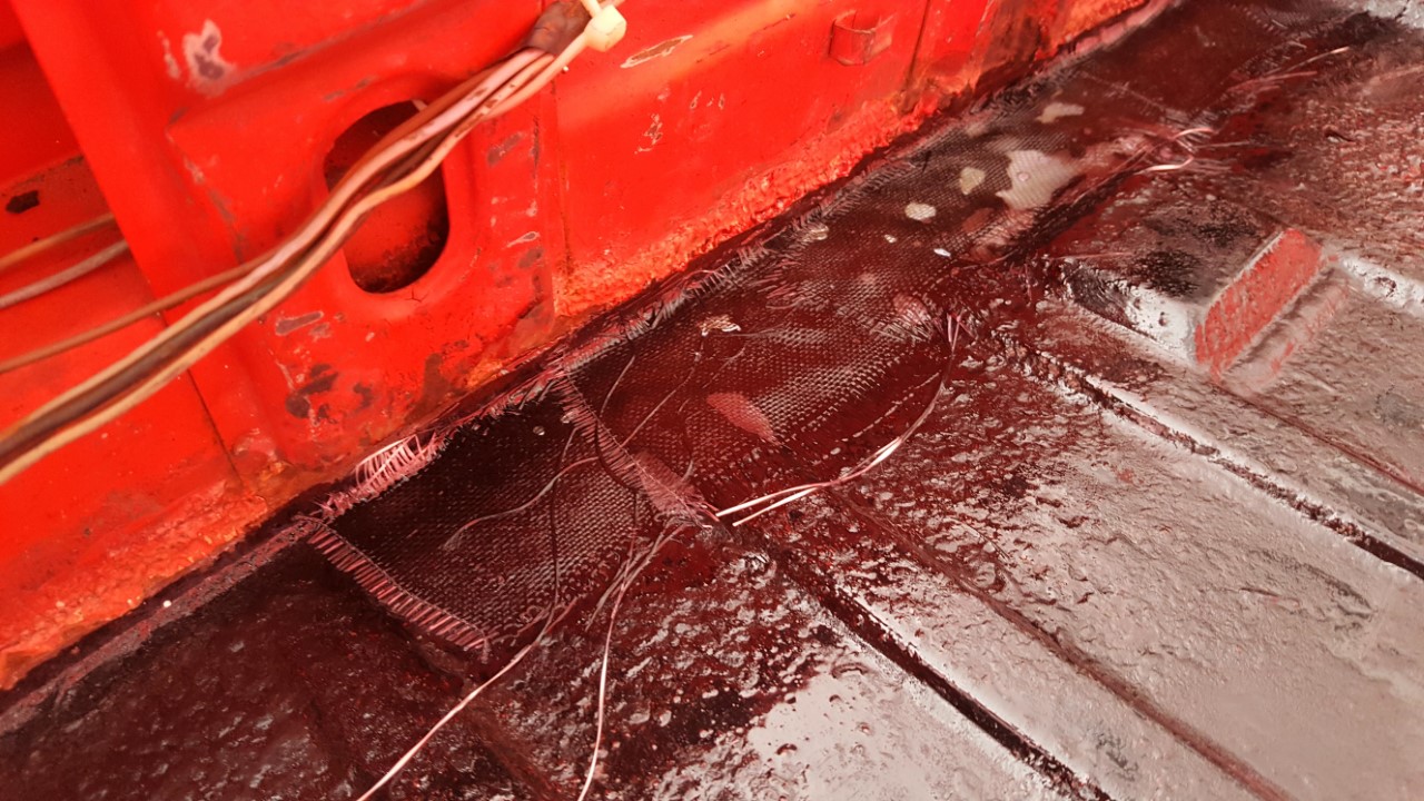

Overall, the car has very little rust (I know, if has some, it has more!). But one of the areas that had to be dealt with was the rear trunk floor. It is rusted through at the low point near the tailight panel. At some point, someone had drilled the trunk lid for a luggage rack and I believe that rain was getting through the holes during the years of outdoor storage. At any rate, it rusted through. I have done a fair amount of proper rust repair in the past, but I needed something quicker and cheaper for now. I cleaned up the rust, coated it in POR-15, and patched it up with fiberglass. It's not great looking but it serves its purpose!

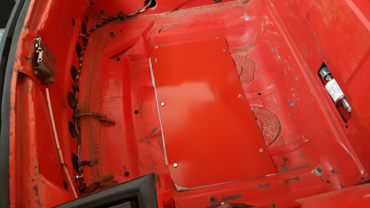

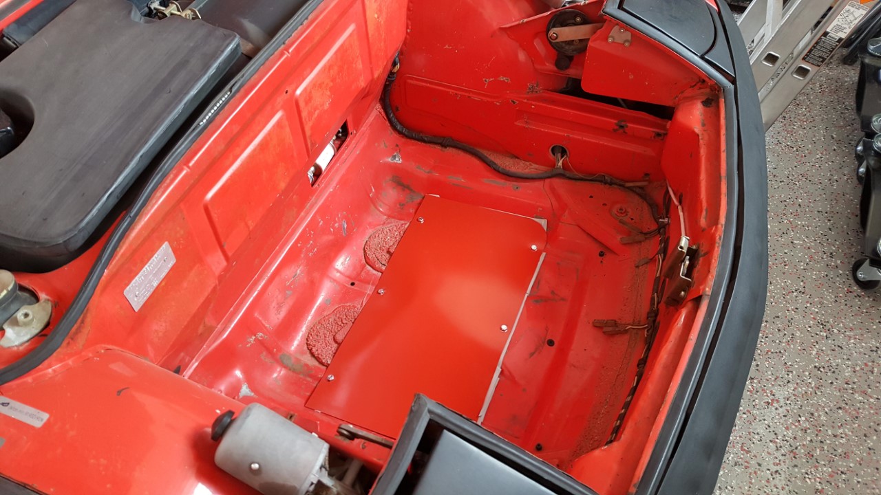

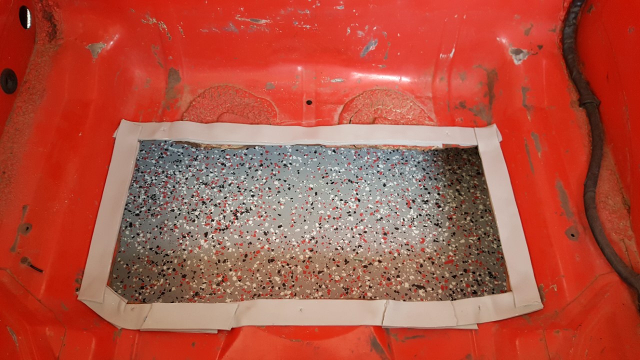

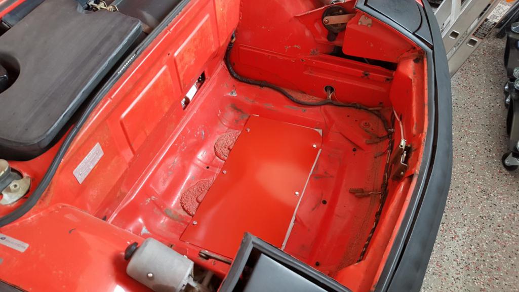

Another issue was in the front trunk where a substantial portion of the floor was cut out for AC, I guess. Some weatherstripping and a sheet metal panel (painted with some automotive paint I had mixed up at a paint supplier) made the trunk serviceable and protected from the elements.
