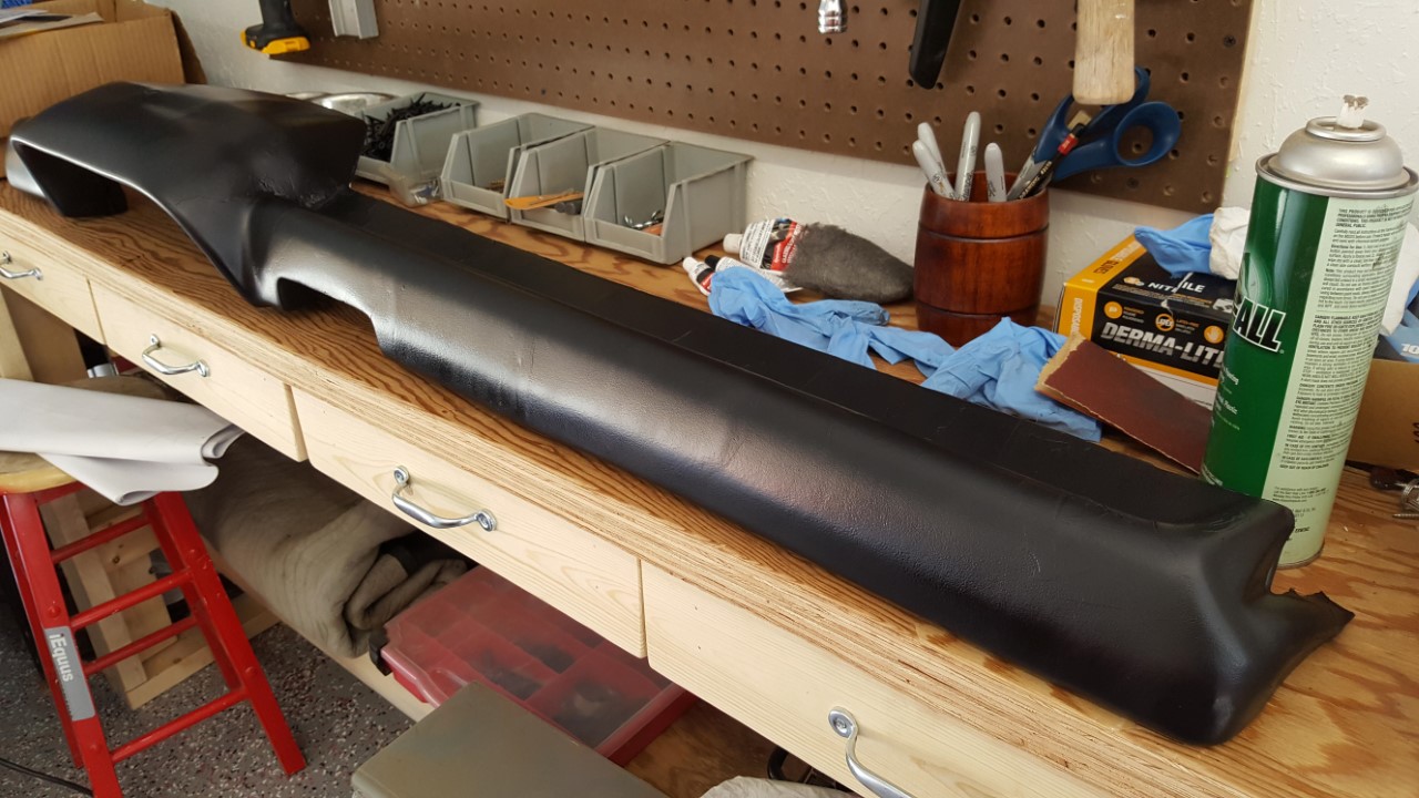

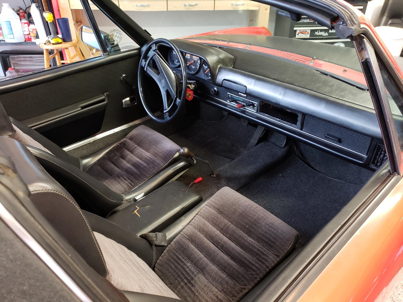

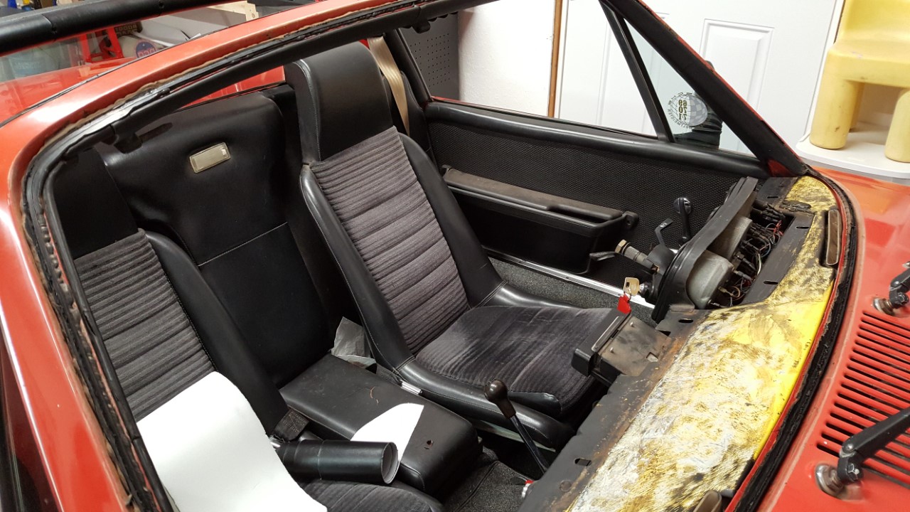

When we found the car in the field, the owner had put in a new windshield. While we were looking over the, car and the various parts he had, he place the extra tach he was showing us on the front cowl near the windshield. Meanwhile, the cable to the front trunk was stuck so we spent a bit of time getting it to open. Finally victorious, we opened the trunk. Well, we forgot the tach was there, so it got squished against the windshield and sent an impressive crack across the glass. (IMG:style_emoticons/default/blink.gif)
So, I had to have another one installed. Which was actually kind of helpful, since I wanted to deal with the dash. It made it a little easier to install the new dash cover (from 914Rubber) that goes between the dash and windshield, as well as a new rubber gasket.
I also did a little repair work on the actual dash.

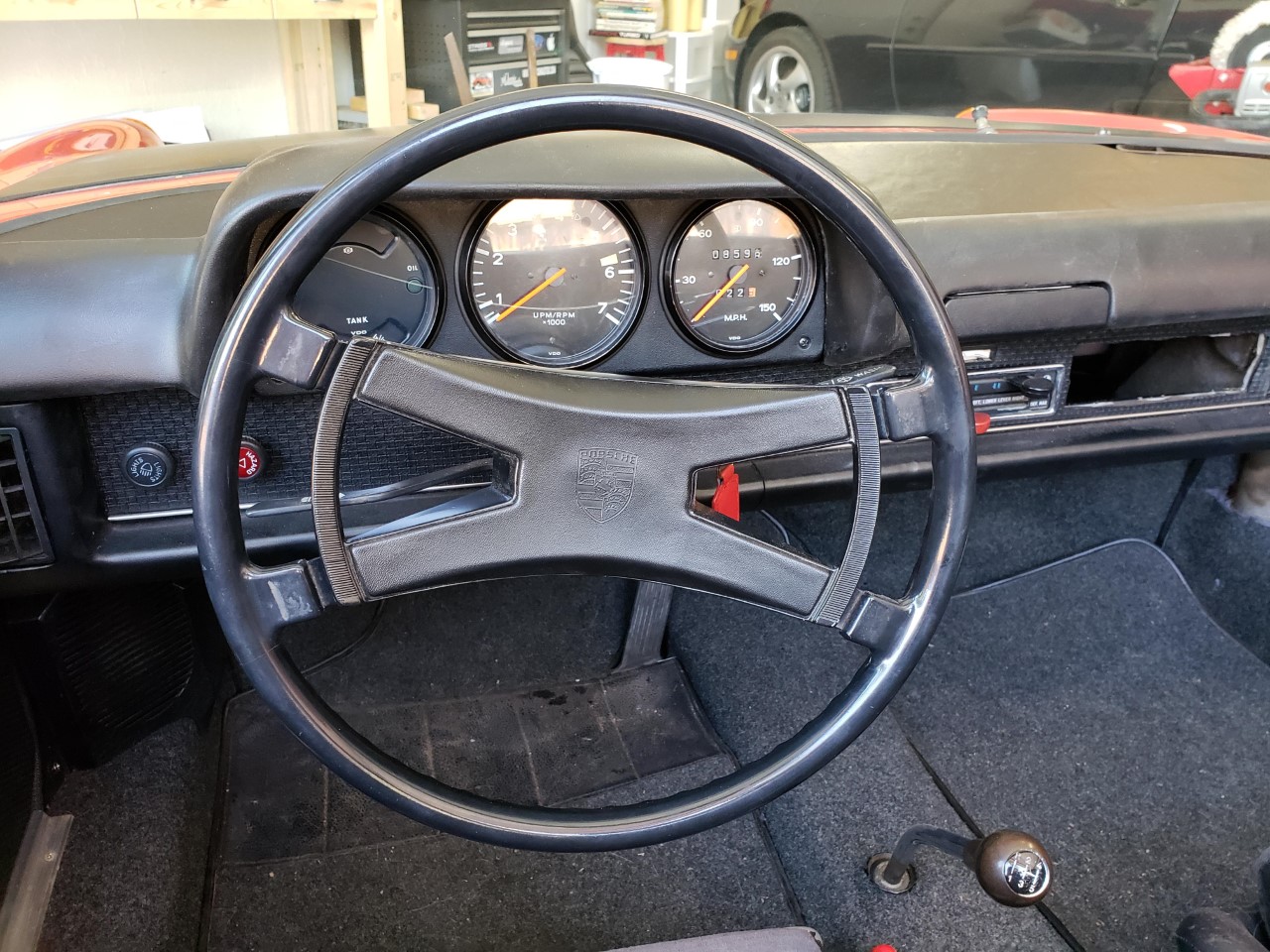

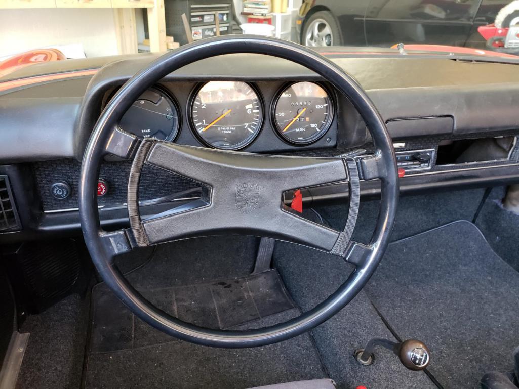

And the steering wheel, which was missing parts for the bowtie horn pad to stay in place, was refurbished. I actually ended up sending the center piece to Rich Bontempi and he sourced the necessary hardware to get it working again. Then I resprayed the rubber pad in low gloss vinyl paint and the metal part in satin enamel.
