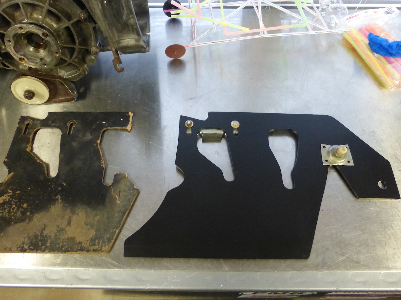

Yup, just trace onto a new piece of 1/4 inch ply, sand and paint. Easy and fun. Best, MarkAttached Image

rgalla9146   On the drivers side it is thin (5/16" ? ) pl...   Apr 21 2019, 06:50 PM
bdstone914   On the drivers side it is thin (5/16" ? ) p...   Apr 21 2019, 09:58 PM

Larmo63   My '73 has the original plywood version too an...   Apr 21 2019, 11:35 PM
bbrock   My '73 has the original plywood version too a...   Apr 22 2019, 07:40 AM
horizontally-opposed   My '73 has the original plywood version too a...   Apr 22 2019, 07:56 AM
DaveO90s4   Even a 1995 928 GTS uses wooden board to cover the...   Apr 22 2019, 03:06 AM

Chris914n6   ?? I have a few 75s that are ply and for all indic...   Apr 22 2019, 12:42 PM
rgalla9146   I just noticed different versions of wood toe boar...   Apr 22 2019, 01:59 PM
Mikey914   I the top one is a later version as the foam cavit...   Apr 23 2019, 10:34 AM
maf914   Various vendors have offered aluminum pedal boards...   Apr 23 2019, 02:27 PM

bdstone914   @AZBanks Remove the rubber pedal covers.It is a ...   Sep 7 2019, 09:21 PM
bbrock   Taking the rubber pads off the brake and clutch pe...   Sep 7 2019, 07:11 PM
ClayPerrine   If you really want a metal one, I will be happy to...   Sep 7 2019, 07:13 PM
mlindner   Yup, just trace onto a new piece of 1/4 inch ply, ...   Sep 8 2019, 04:48 PM
mlindner   But, Mikey's is a great product and priced rig...   Sep 8 2019, 04:53 PM
