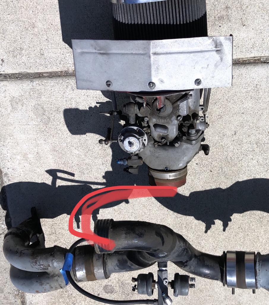

So in the next episode of my ongoing series entitled “this might be a bad idea but...” what if I bypassed the turbo altogether and just connected the Weber to the intake Y manifold as shown in the red scribble?
That would have it set up like the more common (but admittedly not ideal) single carb set up.
I’d get rid of the unnecessary S shape, and since this set up isn’t worth anything to anyone else (unique to put it mildly) so I really have Inc to loose? The Weber wouldn’t be altered.

QUOTE(Tdskip @ Sep 10 2019, 07:57 AM) *
One last time, before i remove myself from this thread.
From the looks of it this was a custom build that included changes to the internals of the engine itself. Those heads are obviously not your typical T4 heads.
Chances are this engine was purpose build for the turbo. If that is the case, removing the turbo and running it off a single carb will give you horrible performance.
