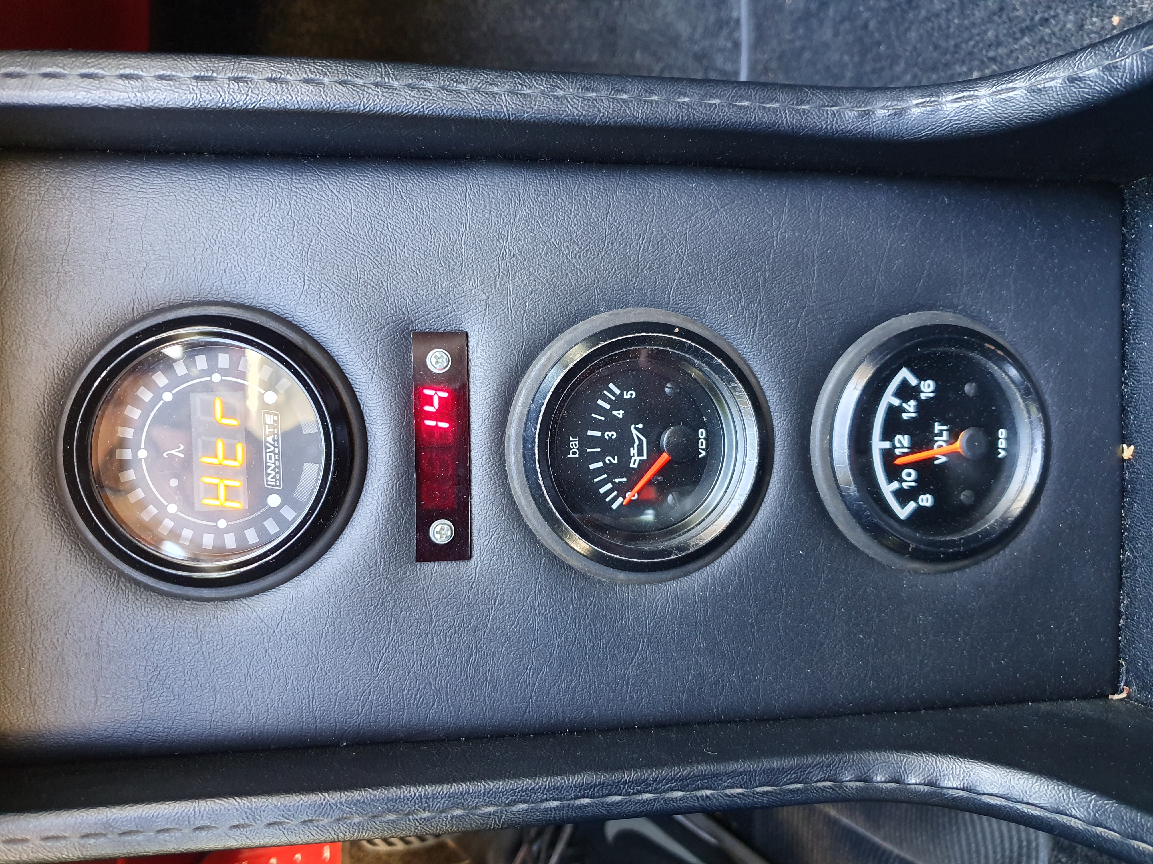

How about posting about your center console setup? Looks interesting.

But here you go:
Slightly modified last winter. Moved Oil Temp Gauge up into the instrument cluster.
Here from top down:
Innovate LC2 Lambda Gauge, modified and fitted into original instrument housing.
CHT Gauge.
Oil Pressure Gauge, new style fitted also into original instrument housing.
Original Voltmeter Gauge.

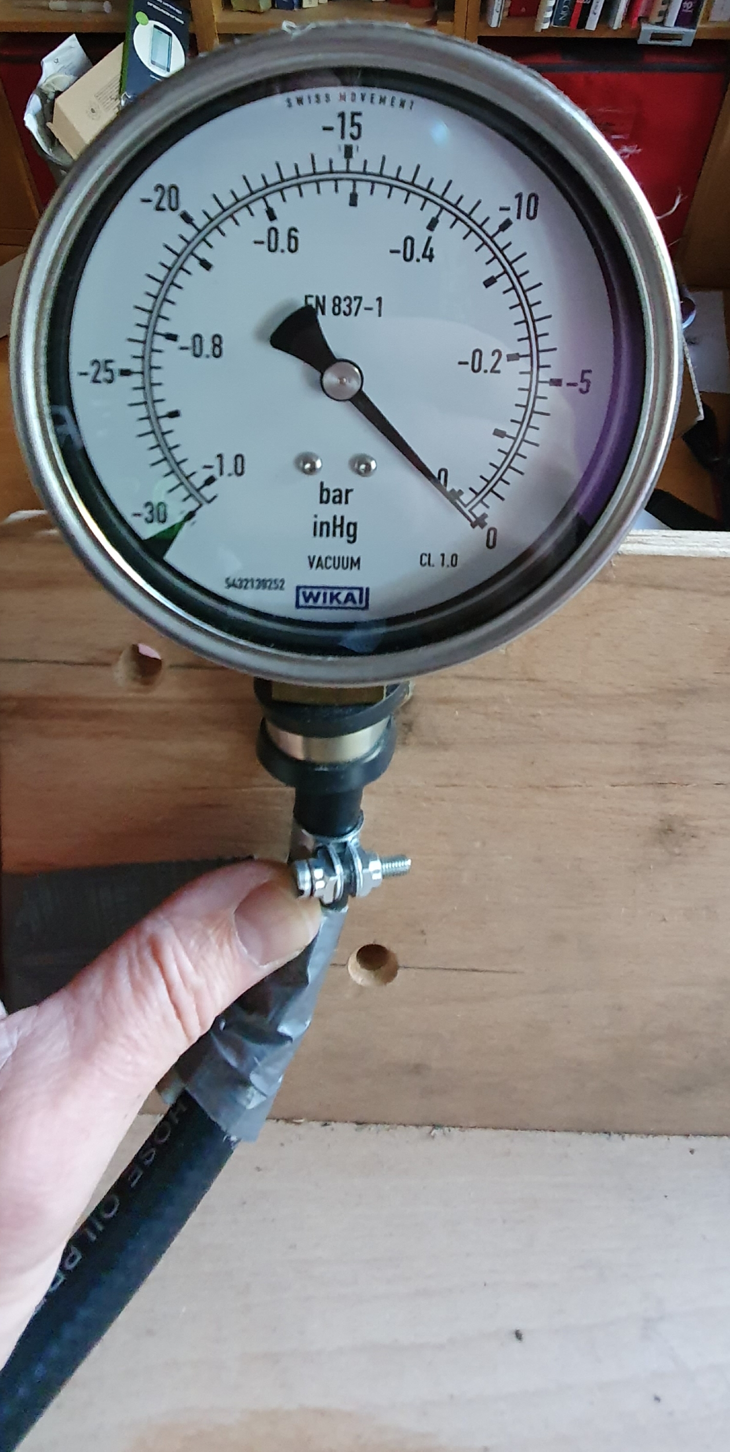

And here the Vacuum Gauge I use for MPS tuning purpose only:
