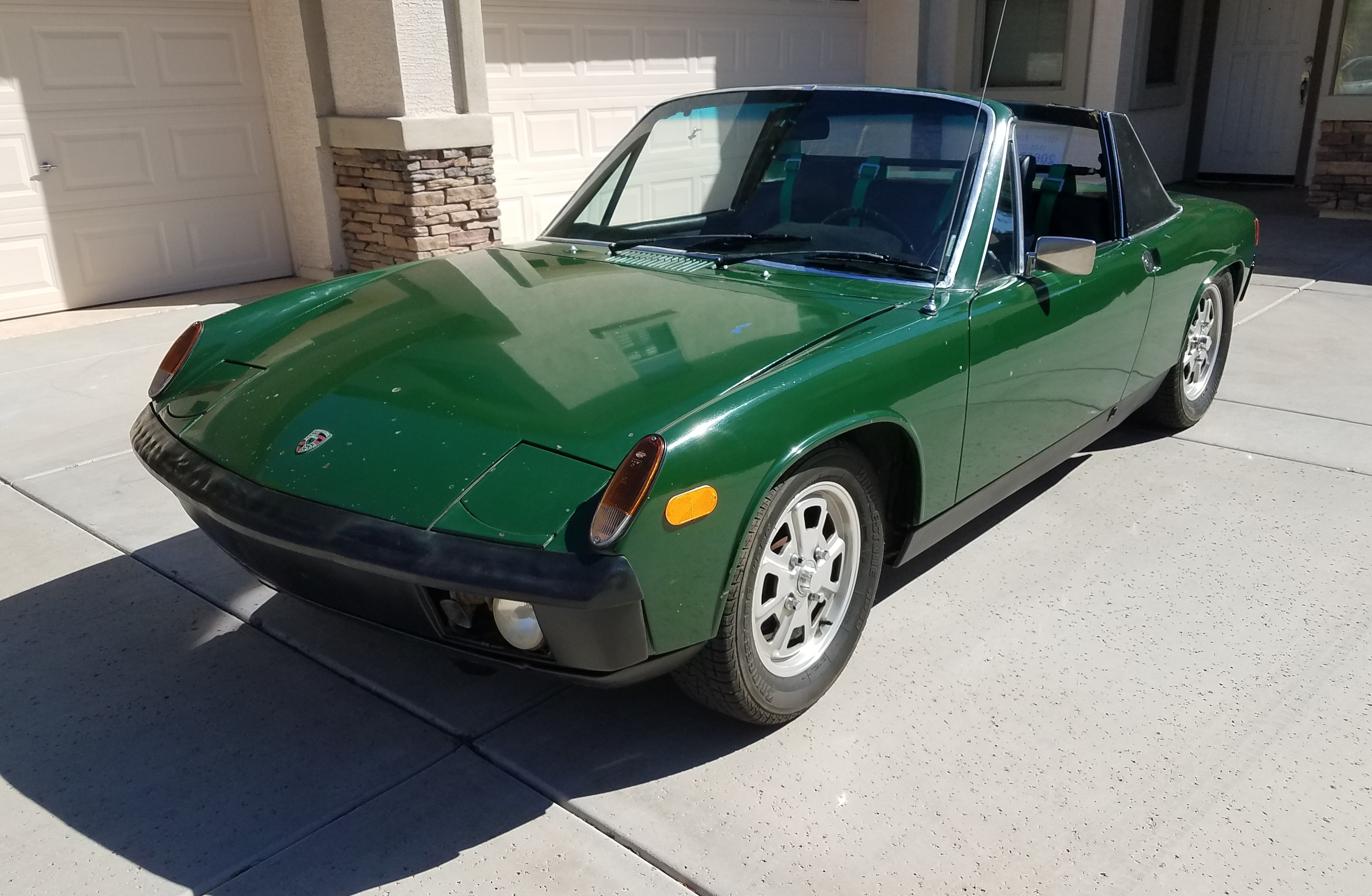

We still have some tuning to do but we got it cleaned up so he can have it in his senior pictures. These are just some camera shots in the driveway. The real senior pictures will look much better.

AZBanks   A few more.   Sep 21 2019, 03:59 PM
AZBanks   More   Sep 21 2019, 04:00 PM

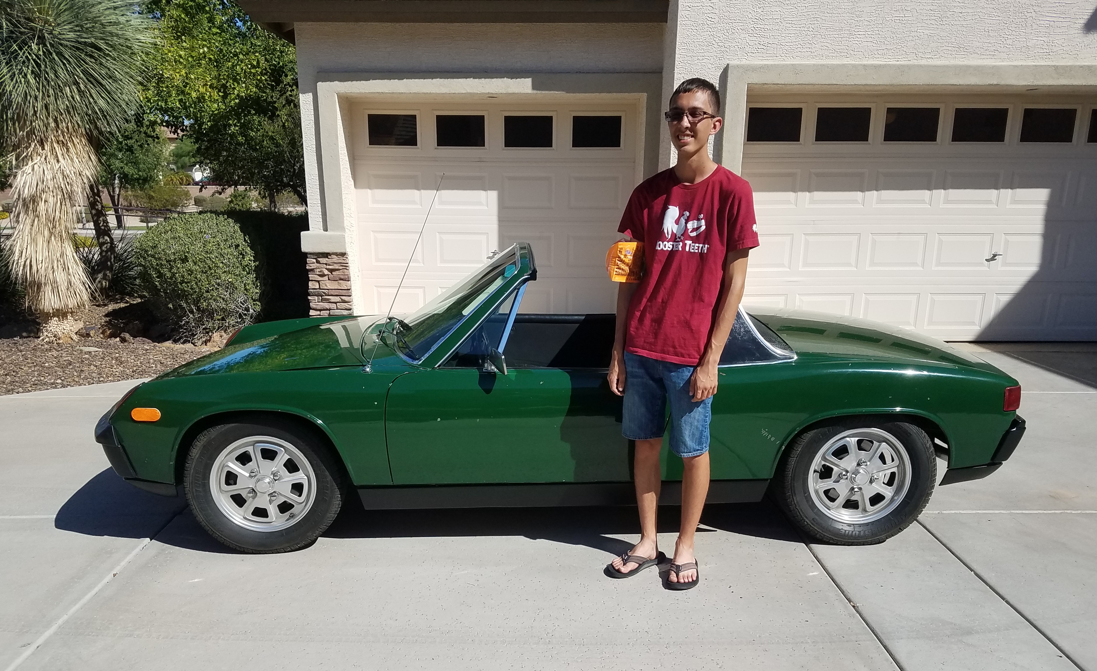

AZBanks   Senior pic   Sep 24 2019, 10:55 AM
bbrock   Coolest senior pic possible. Got the 914 and the ...   Sep 24 2019, 11:06 AM
Maltese Falcon   Nice looking in that shade of green & great Fa...   Sep 24 2019, 11:22 AM
