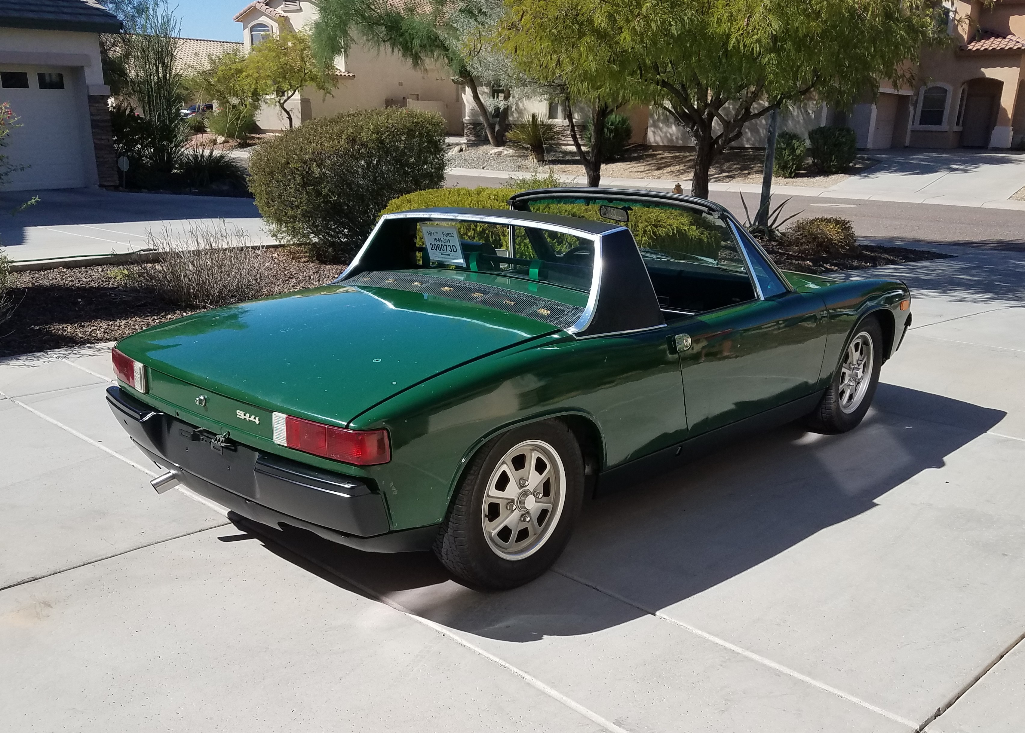

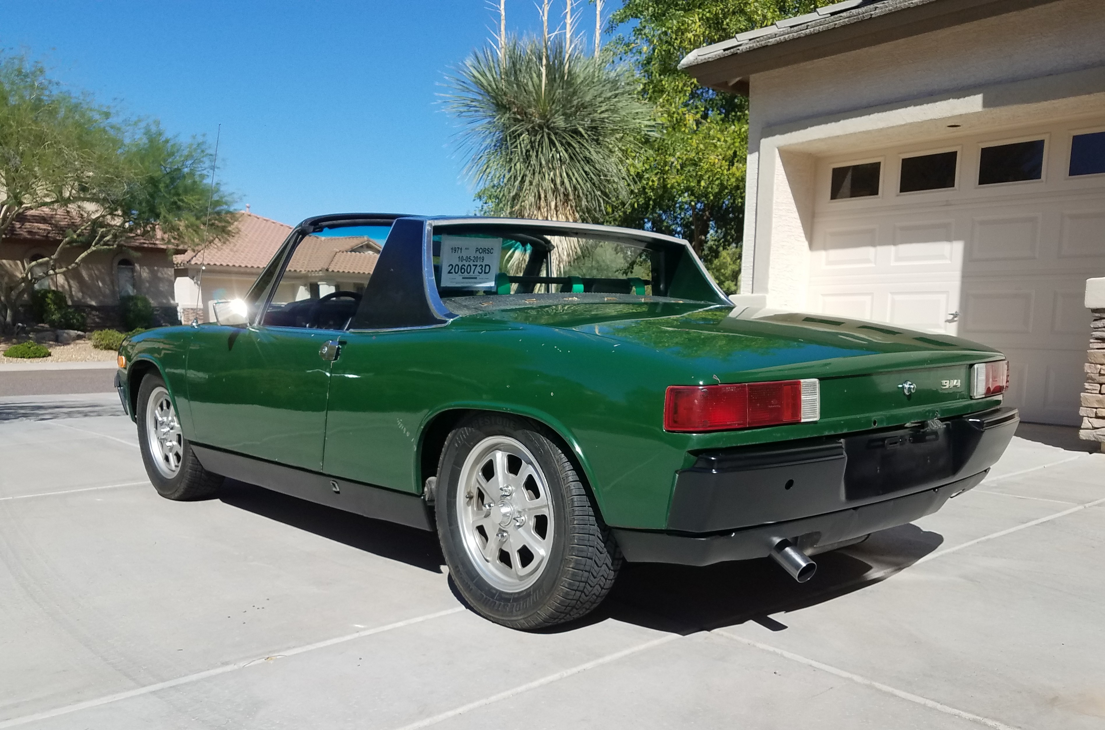

Picked up the new nine-fort-green. Drove to Tucson early this morning, picked it up and drove it back to Phoenix. It got a bit warm in the cockpit with the top off around 11:00 am Phoenix time.

AZBanks   Home sweet home.   Aug 17 2019, 04:15 PM
AZBanks   It is a good 40 footer. The person who painted it ...   Aug 17 2019, 04:19 PM
