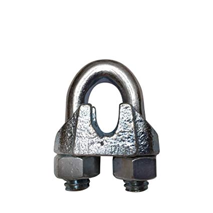

A clable clamp can be used to secure the tube up front to the side of the tunnel.
Kind of fiddly to get in and leaves a couple holes in the side of the tunnel but for short term it might be doable.
Don't over tighten and crush the tube.

QUOTE(jcd914 @ Sep 20 2019, 02:30 PM) *
Jim
I put one of those in Betty's car 30+ years ago when we were dating. We were young and broke, and I didn't own a welder. So that was a quick and dirty fix. It is still there after 300K miles. I know it is not the correct way to fix it, but frankly, it is working. So I am not going to change it now.
Every time I run her car up on the lift, I see the ends of the bolts and I think "Maybe I should fix that right." But I always get distracted and forget about it.
