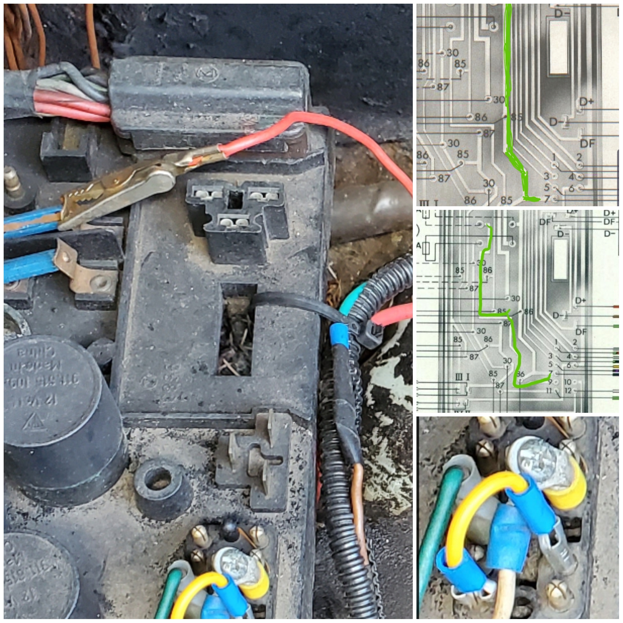

So I am looking at the wiring diagram of the relay board and where he hooked up the sweet "connection" with his roach clip (IMG:style_emoticons/default/blink.gif)
And I am trying to figure out if I can put that in the plug on the board. If so, would it be on the 97 pin or the 9 pin?

Chris914n6   The only thing you need from the relay board is th...   Sep 23 2019, 02:53 PM
burton73   Looking the pictures over one more time. You have ...   Sep 23 2019, 04:13 PM
burton73   Bob B   Sep 23 2019, 04:18 PM
Matty900   Thanks guys for all of the help. I am thinking tha...   Sep 24 2019, 12:42 AM

DickSteinkamp   What is that roach clip/red wire powering?   Sep 26 2019, 08:53 AM
Matty900   What is that roach clip/red wire powering? I wil...   Sep 26 2019, 11:50 AM
Chris914n6   You squiggled the wrong side of the fuse. It's...   Sep 26 2019, 11:47 AM
