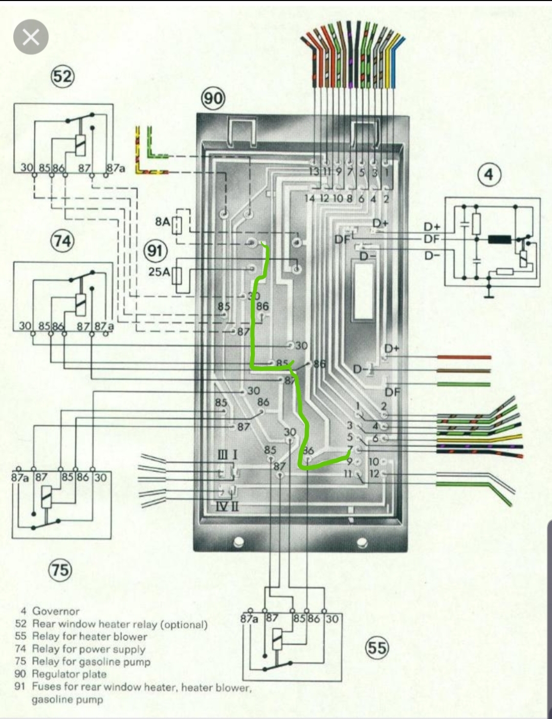

Matty900   So here's where I need the advice of those tha...   Sep 22 2019, 01:53 PM
DickSteinkamp   Oh and it has the original 901 transmission that...   Sep 22 2019, 09:35 PM

Andyrew   It's a V8 car, sketchy wiring is gonna be par ...   Sep 22 2019, 08:20 PM

Chris914n6   The only thing you need from the relay board is th...   Sep 23 2019, 02:53 PM
burton73   Looking the pictures over one more time. You have ...   Sep 23 2019, 04:13 PM
burton73   Bob B   Sep 23 2019, 04:18 PM
Matty900   Thanks guys for all of the help. I am thinking tha...   Sep 24 2019, 12:42 AM
