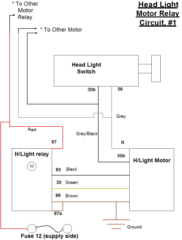

Well, I promised a while ago that if I could get ahold of a program for drawing scematics I would make some quick troubleshooting diagrams for us all. I got Visio2000 and it seems to be adequate for this so I will start posting my schematics as I draw them. If no one is interested let me know and I'll just keep this to myself. Just thought that I might help.
First is the circuit that causes much head ach with the D-jet system. "Why is my fuel pump fuse blowing?" Usually it is because the Auxilary Air Valve is shorting to the block at the plug, but here are the other things involved.
This is of the fuse/relay panel in the left engine compartment:
B+ is the positive side of the battery.
The pointy parts at the end of some of the lines are ground. Consider all grounds to be the same place and to be connected to the negative side of the battery through the cars body. Ask questions if you need clarification.

Here is the first sub circuit of the headlight realy/motor circuit.
The relay pins are as follows:
85 - Headlight Motor auto actuator (up down)
86 - Ground
87a - Ground connected to 86
87 - supply side (opposite side of battery power) of fuse 12
30 - Headlight motor power
Numbers in circles in the blocks are designators from the Haynes manual.
This is a seriously watered down diagram for the novice. It should get you in the right direction. Consult your Haynes manual if this doesn't do it for ya.
