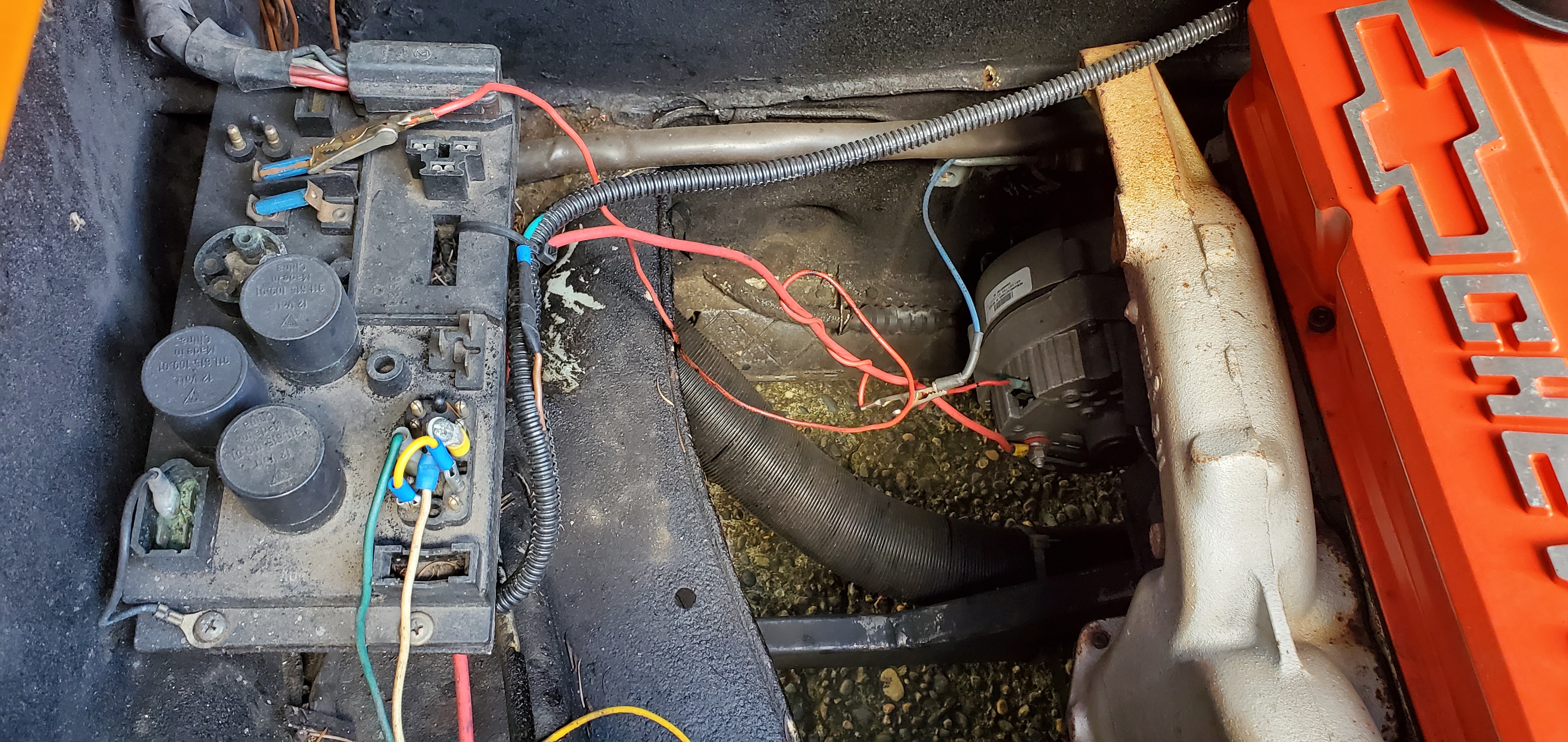

What is that roach clip/red wire powering?

QUOTE(DickSteinkamp @ Sep 26 2019, 07:53 AM) *
I will have to look a little closer. I thought it was exciting the alternator

Chris914n6   The only thing you need from the relay board is th...   Sep 23 2019, 02:53 PM
burton73   Looking the pictures over one more time. You have ...   Sep 23 2019, 04:13 PM

Chris914n6   You squiggled the wrong side of the fuse. It's...   Sep 26 2019, 11:47 AM
