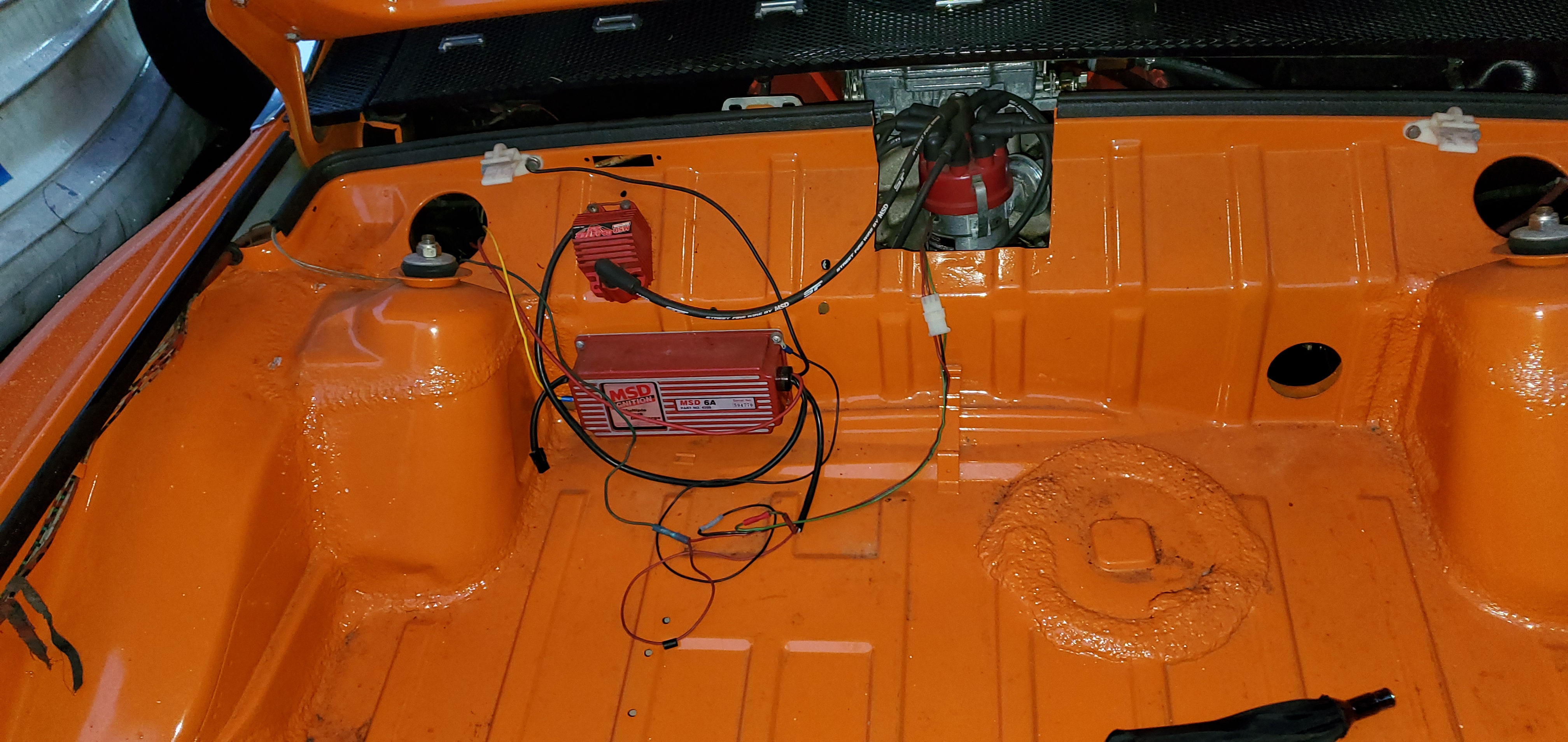

I love that. I would like to repair the trunk and clean up the msd too.

I've seen some nice "dog houses" that cover the dizzy and seal off the rear trunk, and designed so the targa top will still go where it is supposed to go (when the sun comes out unexpectedly here in the PNW (IMG:style_emoticons/default/biggrin.gif) ).
It would also be great to mount your MSD coil and control box so that they don't interfere with targa top storage and the stock place for your jack. I would think both could go in the engine compartment perhaps on the engine side of the rear trunk panel. That's where I mounted my coil. The downside would be that you may have to remove the engine/trans to do it and they might be difficult to service if necessary.

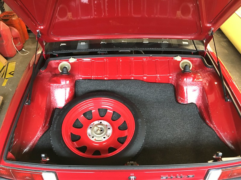

What is the hole for on the right side of the front wall of the trunk?
Here's mine...
(IMG:http://www.914world.com/bbs2/uploads_offsite/live.staticflickr.com-20876-1570910255.1.jpg)
