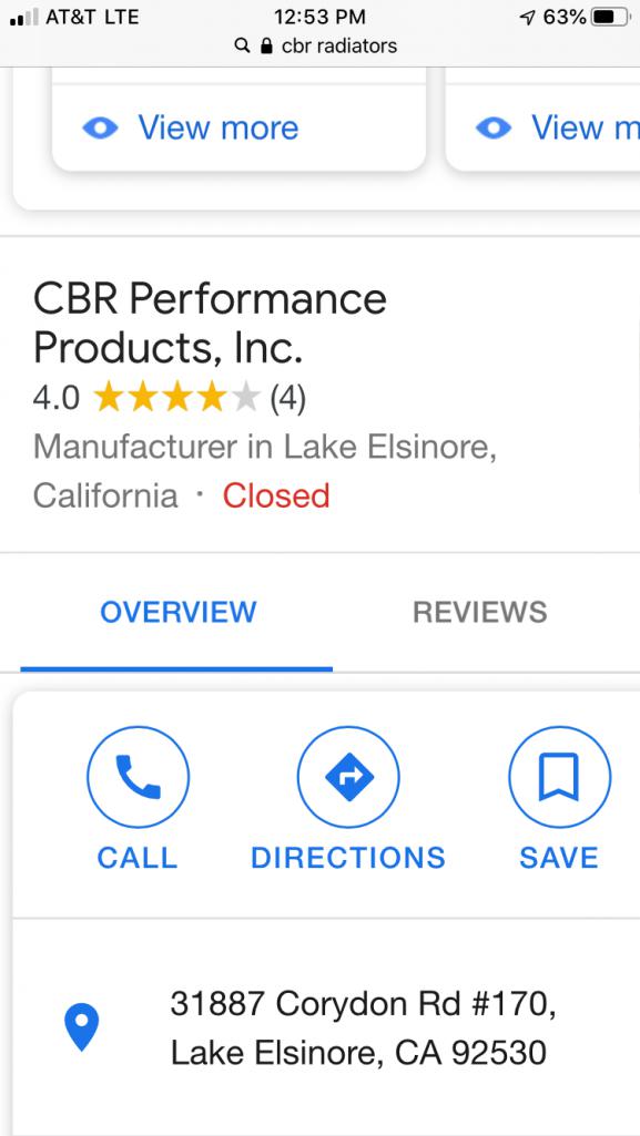

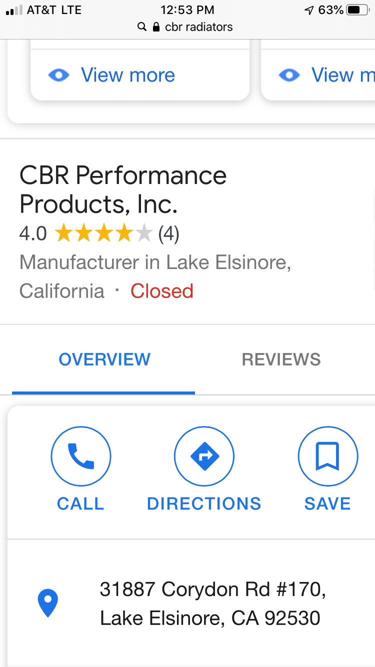

Renegade don’t use Ron Davis no more. Renegade gets then from these guys .
So I went to them and eliminated the middle man . (IMG:style_emoticons/default/biggrin.gif) Attached Image
