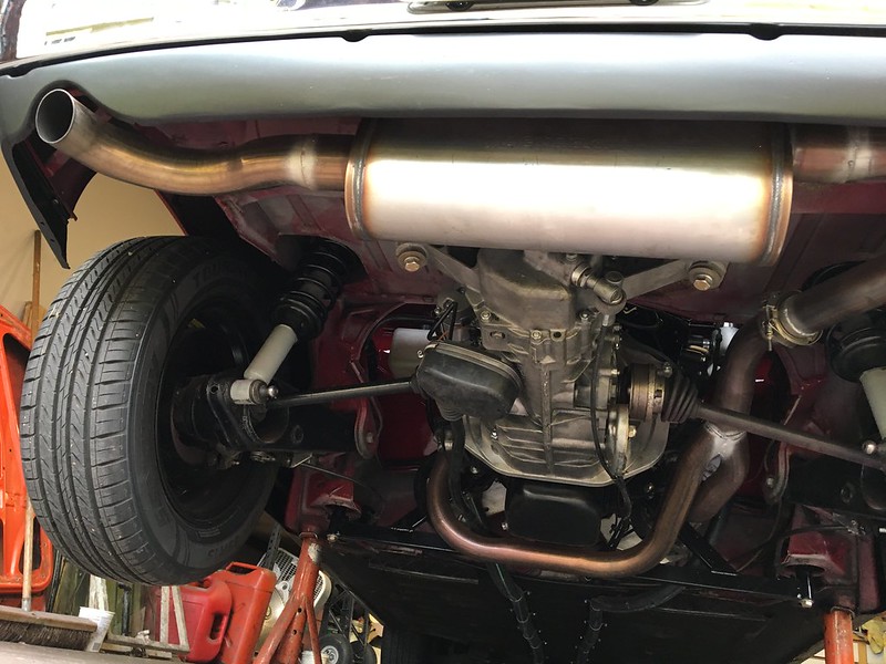

Thanks, Bob...but I called Summit (and Jegs) and talked to their reps about the lowest dizzy they had...manifold to top of cap. I ordered a few from Summit that looked close and no go. In my application I need something with a crab cap at a minimum. It could be my engine is in a slightly different position than yours with the 283. The mechanical advance only dizzy works just fine and I can dial in total advance and when it comes in so that's a plus. I would probably get a few more MPG with a vacuum advance at steady state freeway cruise (I get 20 now) and it may run cooler with the vacuum although that doesn't seem to be a problem (yet (IMG:style_emoticons/default/smile.gif) )
With the exhaust manifolds, I wasn't looking for any more HP with a narrow body and little tires. I wanted it to plumb easy (no bundle of snakes) and look decent. Notice I have a single exhaust also. 2 1/4" to the Y and 2 1/2" after that through the muffler. Keeps things simple. (the rear bar is back on now)
(IMG:http://www.914world.com/bbs2/uploads_offsite/live.staticflickr.com-20876-1571008276.1.jpg)
