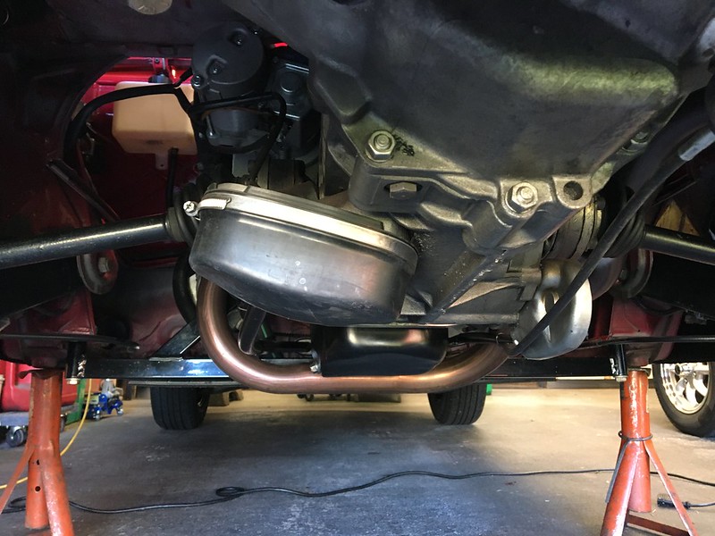

dick, got any video of your car running with that exhaust? how quiet is it? looks real nice.
seems to sit a tiny bit lower than oil pan?

QUOTE(jimkelly @ Oct 14 2019, 08:24 AM) *
The exhaust crossover is about an inch below the pan sump and just under the engine support crossmember. It is the lowest part of the car. I have 1,000+ miles on the car now and have not bottomed on anything. No need to go cross ways over speed bumps. The car is low...but not too low (my grandson would argue with that (IMG:style_emoticons/default/smile.gif) )
(IMG:http://www.914world.com/bbs2/uploads_offsite/live.staticflickr.com-20876-1571100538.1.jpg)
(IMG:http://www.914world.com/bbs2/uploads_offsite/live.staticflickr.com-20876-1571100539.2.jpg)
The exhaust system is all mandrel bent stainless. The muffler is a stainless Magnaflow that I think was made for a truck. I wanted the muffler shop to make the car quiet, but not like a Chevy 6 through a pinched tailpipe. I drive my collector cars. I didn't want it to drone in my ears on the freeway. When you get on the loud pedal it makes all kinds of good noises, but around town you know it's a V8 but it's not obnoxious.
