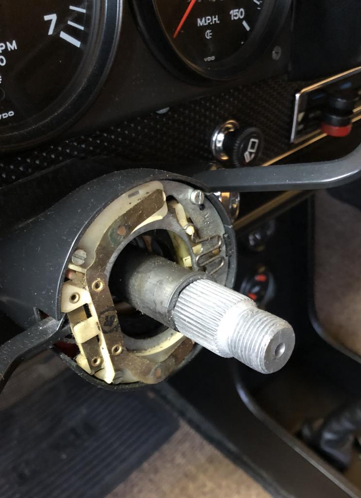

Having already received one Momo solid hub that wouldn't go on the steering shaft, on the recommendation of a gent who I buy tools and custom Porsche parts from I tried Amazon for what was purported to be a MOMO 8002 solid hub.
What showed up from "LTB Autosports" turned out NOT TO BE a solid hub as advertised.
Anyone can plainly see from the measurements this one wouldn't ever work regardless of configuation.
Before I raise the white flag I'm open to suggestions. Jimmy Tidwell made some of these at one time but as the market was covered he prefers to make things you cannot easily buy.
OTOH, Ive got a half dozen cool period wheels looking for a car. (IMG:style_emoticons/default/chowtime.gif)
Thanks
Tom
PS: Box is marked 89-97 Mazda Miata but also has a MOMO 8002 sticker "for Porsche" on it.
sithot
post Aug 16 2019, 02:15 PM
Posts: 451
Joined: 25-October 06
From: Virginia
Member No.: 7,090
Here you go:
Thanks!
Tom

This looks identical to my shaft on my 71 914-4.
Except I don't see the black plastic square "thingy" with the copper horn contact ring that sits on top of it.
I'll have the 8002 hub in about a week with any luck and see if everything mounts up correctly and report back here.

raynekat   First....what year is your 914? Looking at this s...   Oct 23 2019, 10:50 PM
sixnotfour   If you have a 70-71 914,, with the a 70-71 column,...   Oct 24 2019, 01:39 AM
sixnotfour   luisi model S5904 http://classicgarage.com/s5904....   Oct 24 2019, 02:04 AM

Chi-town   Easiest way to tell an early column from a late co...   Oct 26 2019, 07:37 AM
