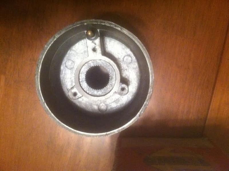

Having already received one Momo solid hub that wouldn't go on the steering shaft, on the recommendation of a gent who I buy tools and custom Porsche parts from I tried Amazon for what was purported to be a MOMO 8002 solid hub.
What showed up from "LTB Autosports" turned out NOT TO BE a solid hub as advertised.
Anyone can plainly see from the measurements this one wouldn't ever work regardless of configuation.
Before I raise the white flag I'm open to suggestions. Jimmy Tidwell made some of these at one time but as the market was covered he prefers to make things you cannot easily buy.
OTOH, Ive got a half dozen cool period wheels looking for a car. (IMG:style_emoticons/default/chowtime.gif)
Thanks
Tom
PS: Box is marked 89-97 Mazda Miata but also has a MOMO 8002 sticker "for Porsche" on it.

If you have a 70-71 914,, with the a 70-71 column,, you need the even more rare
MOMO hub 8000......it has the deeper recess you mention

sixnotfour   FYI,,there is 2 8002,,,,the og one solid alum, the...   Aug 16 2019, 11:33 AM

sixnotfour   send it back ,,,, #1 the one they sent is not a so...   Aug 16 2019, 02:21 PM

Chi-town   Momo doesn't make a solid hub any longer from ...   Aug 16 2019, 03:53 PM

raynekat   So I cancelled may 8002 order with Pelican, and or...   Oct 24 2019, 02:25 PM

raynekat   So here's the problem with the Luisi hub. It a...   Nov 6 2019, 10:10 PM
raynekat   As compared to the factory wheel/hub which has it...   Nov 6 2019, 10:11 PM
raynekat   Well it is a problem when you consider the horn ri...   Nov 6 2019, 10:17 PM

raynekat   Gave up on the Luisi hub. It's not going to fi...   Nov 17 2019, 11:09 PM
raynekat   Momo 8000 hub attached to my Momo Prototipo.   Nov 17 2019, 11:10 PM
raynekat   This is the type of Momo horn button I have. Has t...   Nov 17 2019, 11:16 PM
