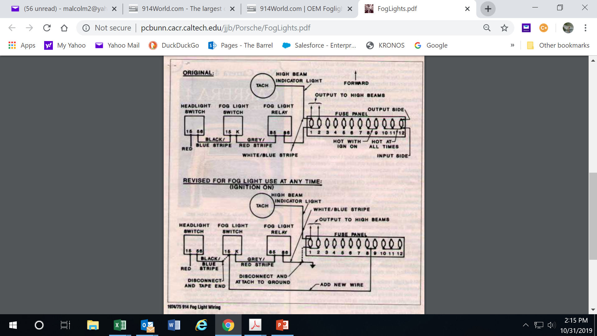

http://pcbunn.cacr.caltech.edu/jjb/Porsche/FogLights.pdf
and old Porsche Panarama magazine article. 3rd page shows this.....

malcolm2   http://pcbunn.cacr.caltech.edu/jjb/Porsche/FogLigh...   Oct 31 2019, 02:02 PM
malcolm2   Am I getting this thread right? You guys on...   Oct 31 2019, 06:05 PM
FlacaProductions   I just did the grounding wire - nothing else other...   Oct 31 2019, 06:15 PM
malcolm2   I just did the grounding wire - nothing else othe...   Oct 31 2019, 07:06 PM
FlacaProductions   You might need @Spoke EP26 relay so it all plays...   Oct 31 2019, 07:23 PM
