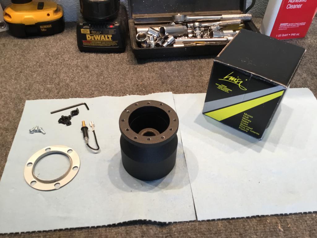

The hub adapter kit showed up today from Classicgarage.com.
It's a good new/bad news story.
The good news first.
All the parts "look" good, but looks can be deceiving as they say.
The company that makes these is Luisi out of Italy.
I ordered the S5904 that is supposed to be for 69-71 914's.
Here is a pic of the parts you get.
The silver ring that the horn button is supposed to snap into has an ID that is too big to accommodate a standard Momo horn button.
Luckily most Momo wheels come with the correct silver ring that has the right ID for your horn button. Issue dodged there.
The adapter itself slides onto the column splines correctly and pushes on just right.
There is no big gap between the backside of this hub and where it meets up to the rest of the column.

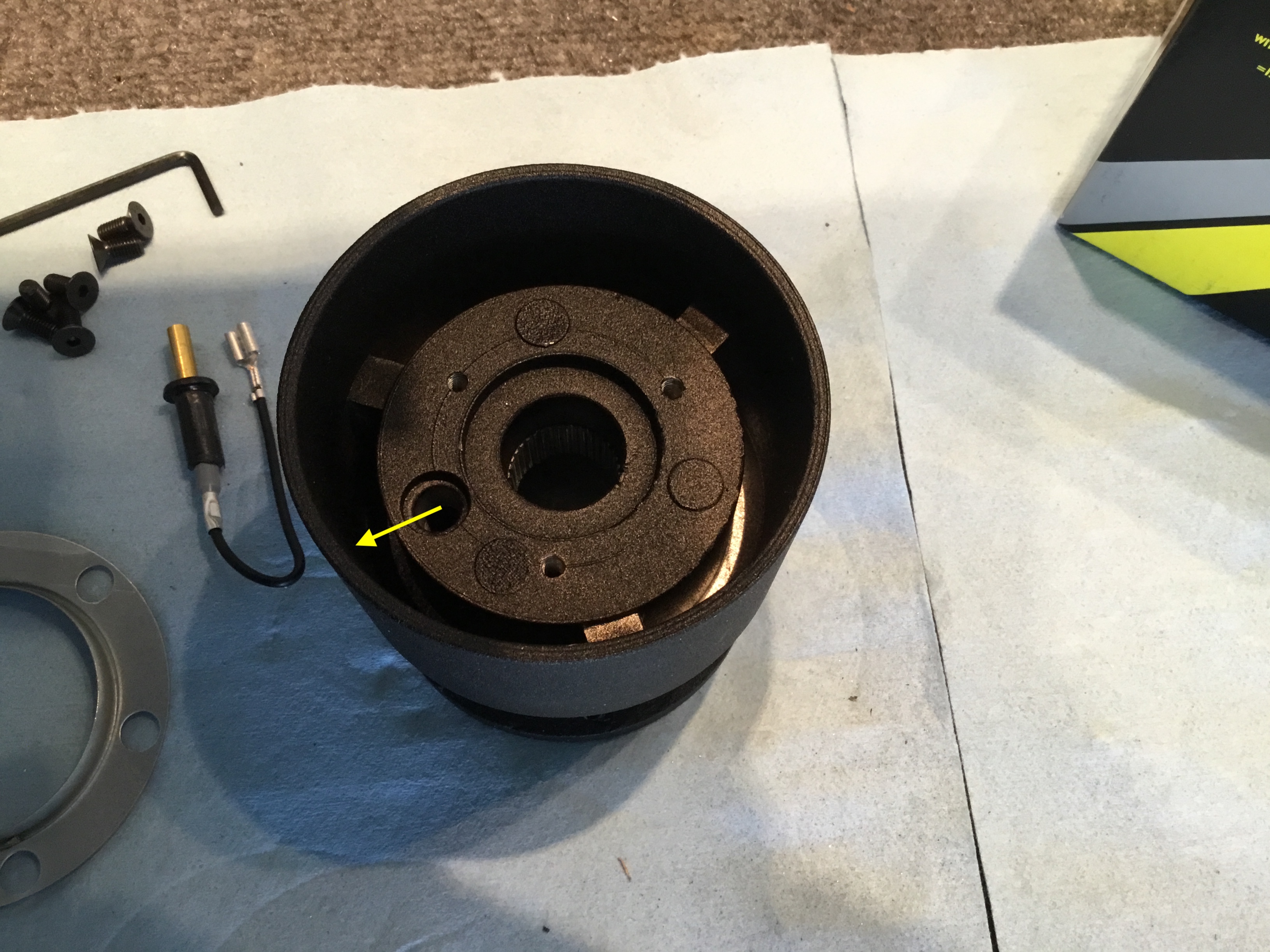

Now comes the deal breaker to me....
See pic below.
The hole where the spring loaded contact pin is supposed to go is way too far inboard.
See yellow arrow.
The location for the contact pin needs to be a good 1/4 - 3/8" farther out.
Where it's located now, the pin won't ride on the copper contact ring but on the screws that locate the ring.
That's just not going to work.
Your steering wheel will either stop turning when the contact pin hits one of the contact ring screw heads.....or you'll just shear off or bend the contact pin.
Nice!
If you look at the Momo 8000 pictured in post #16, you can see that the contact pin on that hub is outboard much farther than where the Luisi hub contact pin location will be.
Time to come up with another solution as the correct Momo 8000 hubs are NLA.
