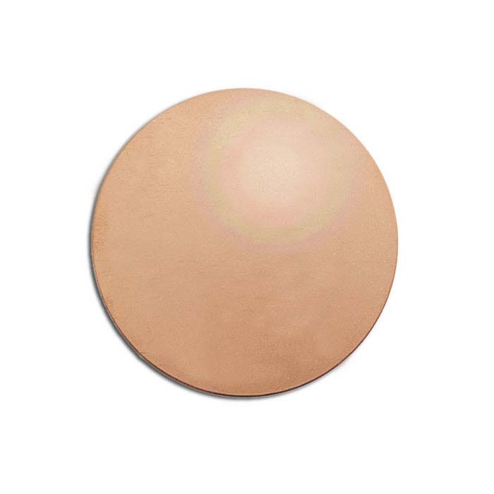

Ordered a 3" 18 Ga copper disc today.
Will attempt to make a custom horn contact disc for my car.
Need a 1.5" ID hole in the middle plus a few small holes on the perimeter for mounting and it might just work.
I like the Liusi hub....just the horn contact pin is located incorrectly in their design.
Stay tuned.
I was going to try using the horn contact ring off a 911, but I'm not sure it's any better than the 914 ring I currently have.

raynekat   Ordered a 3" 18 Ga copper disc today. Will...   Nov 5 2019, 06:28 PM

raynekat   So here's the problem with the Luisi hub. It a...   Nov 6 2019, 10:10 PM
raynekat   As compared to the factory wheel/hub which has it...   Nov 6 2019, 10:11 PM
raynekat   Well it is a problem when you consider the horn ri...   Nov 6 2019, 10:17 PM
infraredcalvin   How about moving the screws outward and filling t...   Nov 6 2019, 10:29 PM
sixnotfour   :sawzall:   Nov 7 2019, 09:02 AM
raynekat   Gave up on the Luisi hub. It's not going to fi...   Nov 17 2019, 11:09 PM
